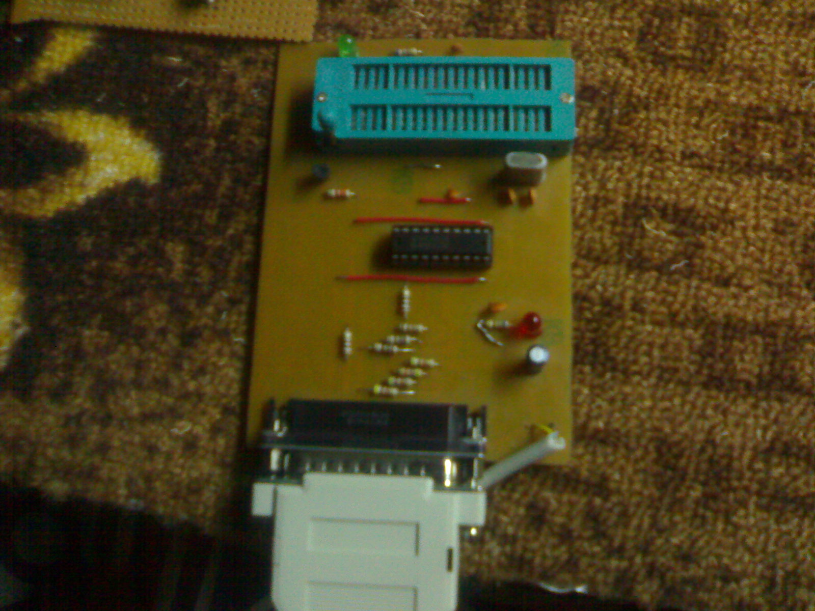

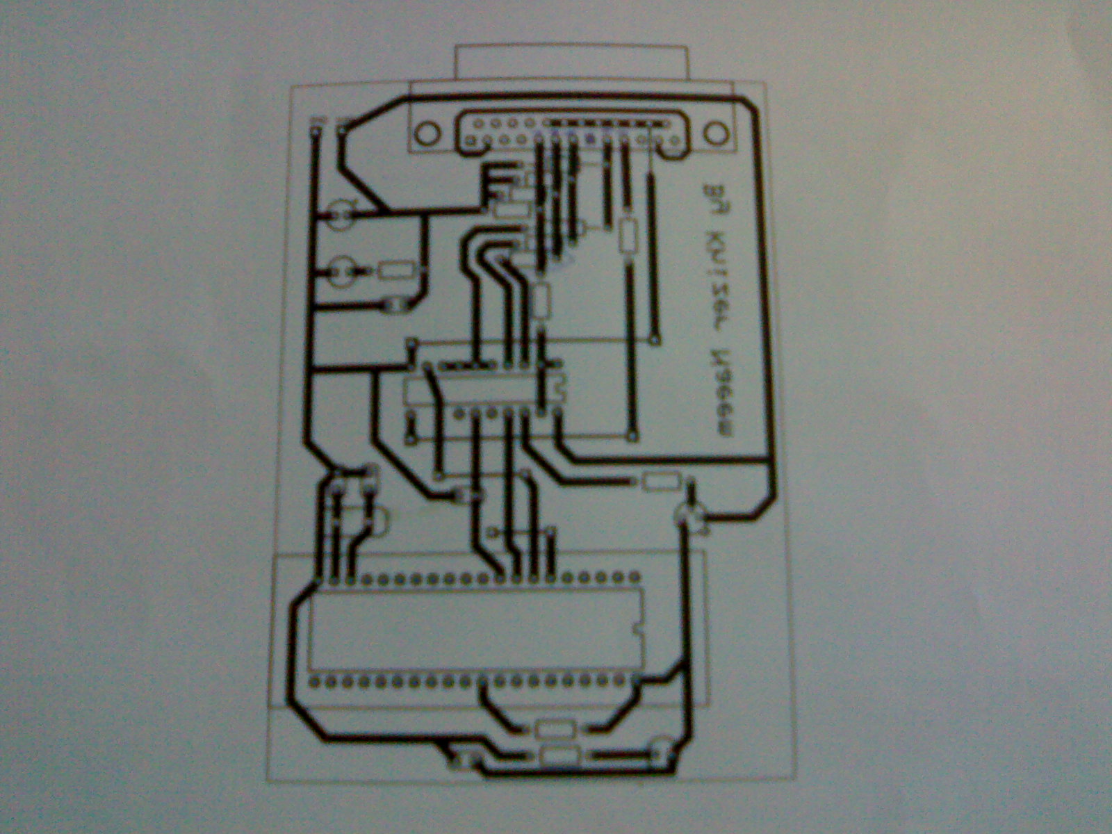

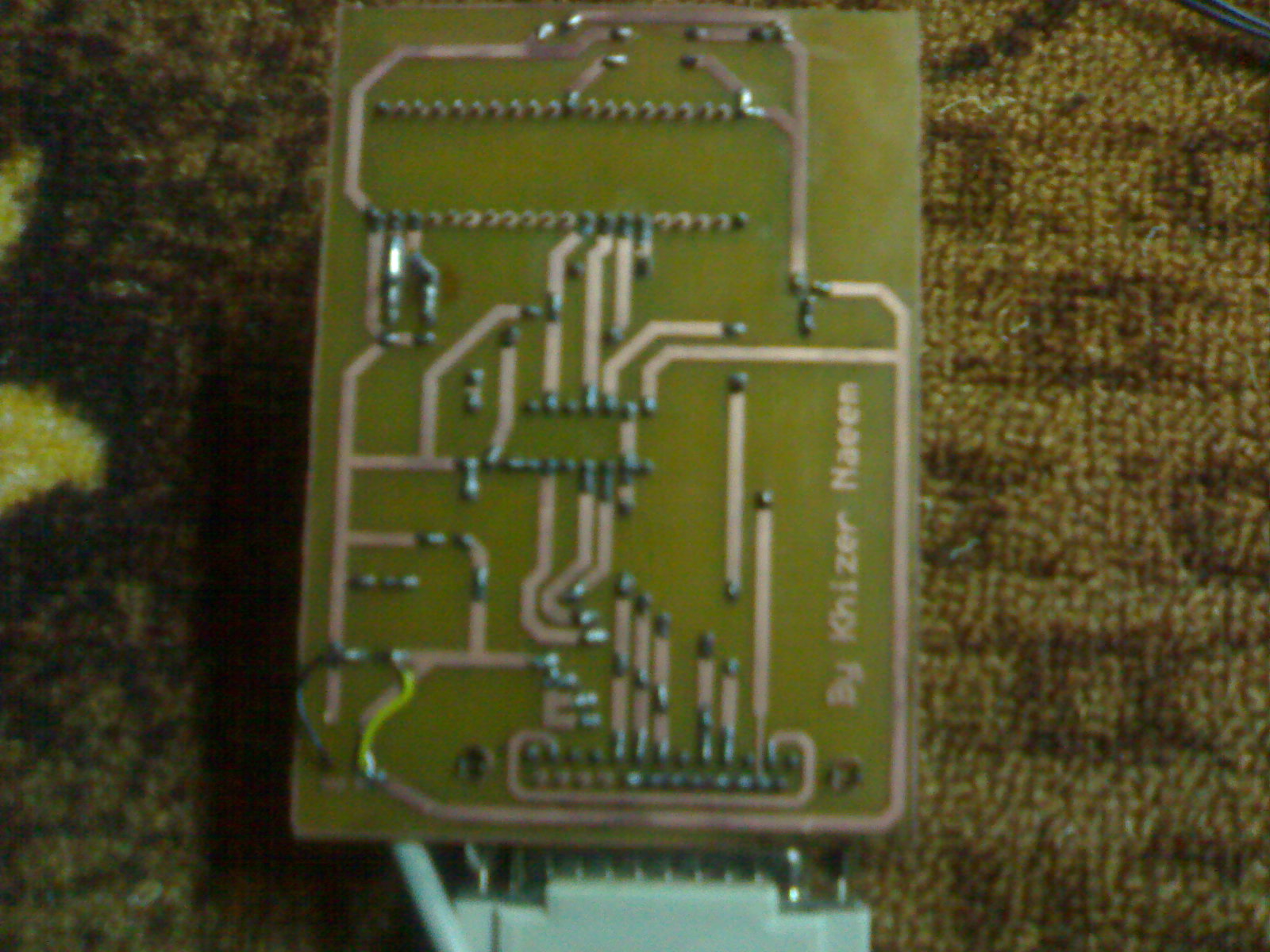

With the help of Rolf, I finally get to make the PCBs(single sided ofcourse). He really helped me a lot.
ExpressPCB is an excellent choice for the beginners. I have attached some pics of the PCB i have made.
I thank every one who helped me do this.
Any suggestions and comments are wellcomed.

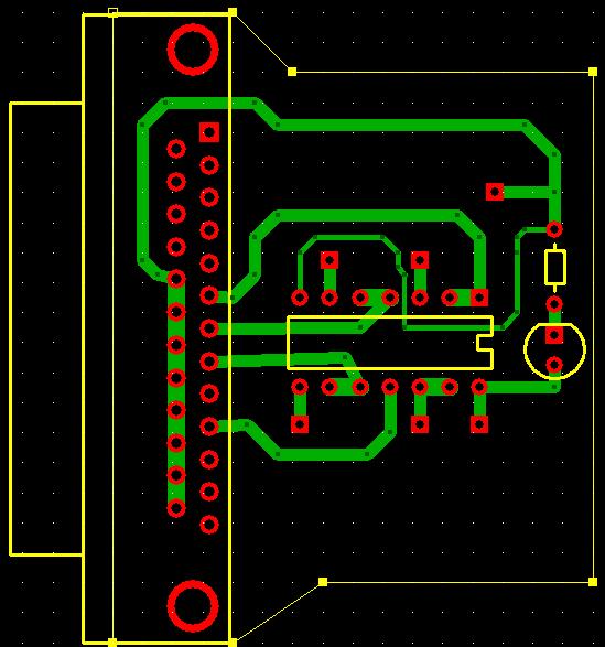

Cry_Wolf said:
Ok Now I went for the Express PCB. It is no doubt an easy software for the beginner. Ok Now my question :D
I have drawn the following circuit (**broken link removed**)
The PCB i drew is attached.
--> What should I do if two nets cross each other? What I mean is that if i want to connect point A with B (in the image) what should I do? I am using single sided PCB!
--> Any suggestions regarding the PCB layout?
Uou can simply use a resistor on the layout, and replace it with a wire on your real PCB :) it's called a jumper!
