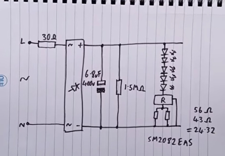

The circuit is based on this:- https://pdf1.alldatasheet.com/datasheet-pdf/view/1140947/BPS/BP5131HC.html
I think that the IC has gone intermittent. I was just measuring voltages when it went to full brightness, and it seems to be working now.
With the IC in its failed state, there was just a small current in the LEDs and the 4.7 uF capacitor could keep the LEDs glowing for half a second or so after the power was removed.

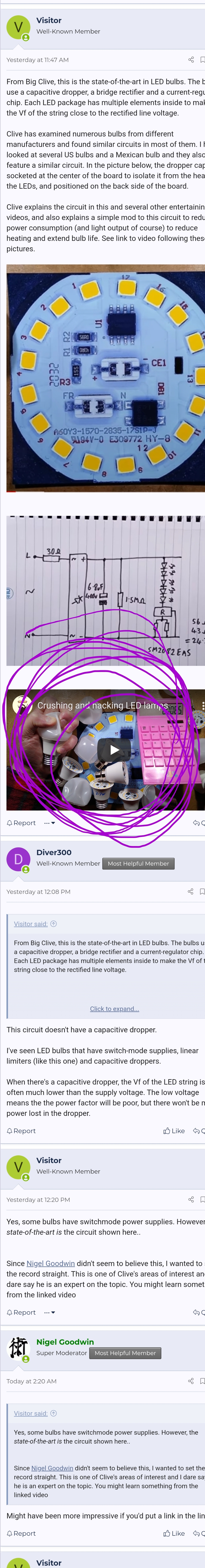

From Big Clive, this is the state-of-the-art in LED bulbs. The bulbs use a capacitive dropper, a bridge rectifier and a current-regulator chip. Each LED package has multiple elements inside to make the Vf of the string close to the rectified line voltage.
Clive has examined numerous bulbs from different manufacturers and found similar circuits in most of them. I have looked at several US bulbs and a Mexican bulb and they also feature a similar circuit. In the picture below, the dropper cap is socketed at the center of the board to isolate it from the heat of the LEDs, and positioned on the back side of the board.
Clive explains the circuit in this and several other entertaining videos, and also explains a simple mod to this circuit to reduce power consumption (and light output of course) to reduce heating and extend bulb life. See link to video following these pictures.
This circuit doesn't have a capacitive dropper.
I've seen LED bulbs that have switch-mode supplies, linear limiters (like this one) and capacitive droppers.
When there's a capacitive dropper, the Vf of the LED string is often much lower than the supply voltage. The low voltage means the the power factor will be poor, but there won't be much power lost in the dropper.
Yes, some bulbs have switchmode power supplies. However, the state-of-the-art is the circuit shown here..
Since Nigel Goodwin didn't seem to believe this, I wanted to set the record straight. This is one of Clive's areas of interest and I dare say he is an expert on the topic. You might learn something from the linked video
