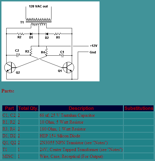

audioguru said:
An astable multivibrator using silicon transistors harms the transistors if the supply voltage is more than about 6V which is the absolute max allowed voltage for the reverse emitter-base voltage for a silicon transistor. The emitter-base junctions have avalanche breakdown.

The continuing avalanche breakdown of the emitter-base junction of a transistor might cause its hFE to reduce to 50 from the original 200. But a simple mulivibratpr will keep on oscillating until the hFE drops below maybe 10 (depending on the value of its base resistors).
A high frequency oscillator might destroy its transistors sooner than a very low frequency oscillator.

Here is an "inverter" that has its transistors' emitter-base junctions always avalanching.
The capacitors blow up. The capacitors are backwards too. They even blow up when they are not backwards because the avalanche breakdown current is very high in them.
The author say it produces an output of hundreds of watts but people who built it say 35W at a low voltage.
