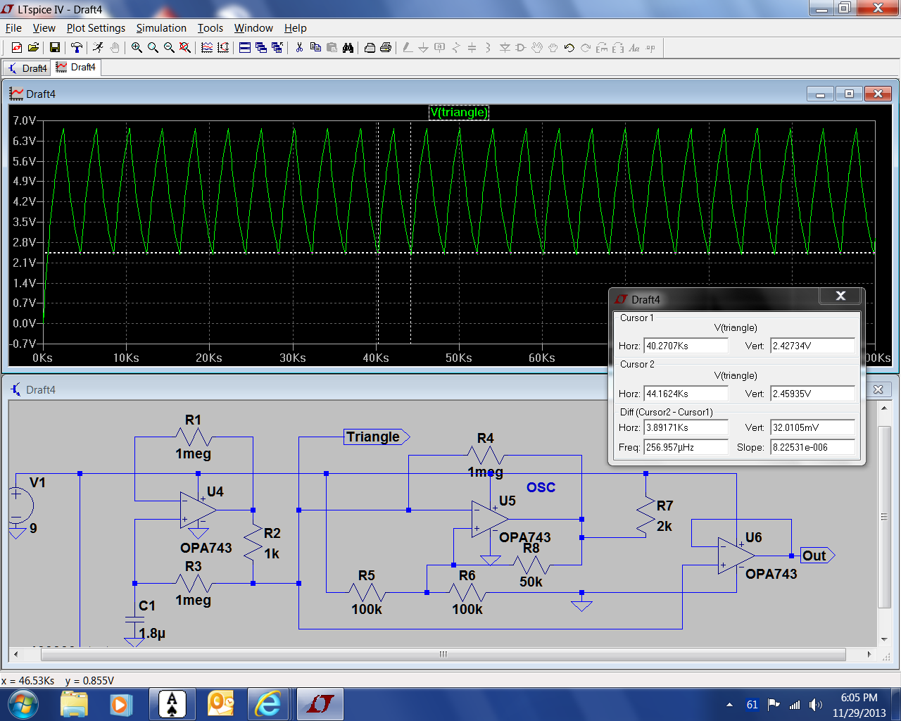

I need to produce a sinusoidal or triangular oscillation with a period of around 30-60 minutes. The circuit needs to be simple and have a low component count, and it's running off batteries (4.5V) so single supply would be best. Quadrature output would be ideal but if not then I can just use an inverter to get the quadrature signal.
I looked at using the typical opamp triangle wave generator or sinusoidal generator but so far they do not seem to be working. I think the resistor values for such a low frequency are too high. I am simulating in LTSpice at the moment, although it is late so it is possible I am not thinking straight and missing something.
Could somebody advise on a circuit that could do this? I basically want to build a light which fades from white to red and back to white over a period of around 1 hour. I will be using LED's for the lighting but don't want to use PWM as the lights will will be filmed and I do not want flickering on the video.

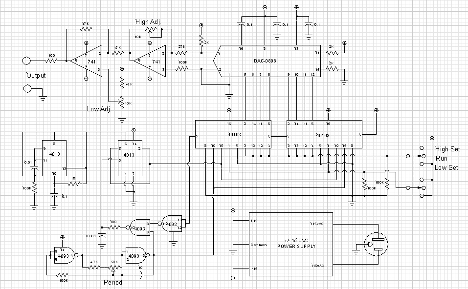

Here is a circuit for a slow triangle-voltage motor speed control for a medical application that I built many, many years ago. The circuit allowed you to set the minimum and maximum motor speed. Then it would step up and down 256 levels between those points. If you are going full on to full off and at a Vcc=4.5V, you can dump the switch and 741 circuits and put a different opamp in to drive your
LEDs....I think.
Ken

KMoffett: Thanks for the circuit diagram. Will look at it a properly tomorrow. I've looked at the counter and DAC idea and it may be my best option, taking time and component availability into account. But will decide after examining your other circuit further tomorrow.
If I go with the counter and dac, I will have to cascade 3 up/down counters to get 12 bits. Do I then connect the carry out pin to the following devices carry in pin or to the clock pin? The datasheet refers to this as parallel or ripple clocking. I need a triangular output, not sawtooth, so need to count down after counting up. Am I correct that I will achieve this by connecting the final stage carry out pin to the up/down pins on the cascaded device?
Ripple clocking will cause noise that you don't want. Parallel clocking is what you need.
The CD40193 has two clock inputs. clock up and clock down which might be hard to deal with.
The CD4516 has one clock and a input: "up/down" I think, with every carry out you need to flip a FF. This flip flop will drive the up/down pin. So to say that another way; every the counter hits last last count (o if counting down, OR FFF if counting up) change the state of the up/down pin.

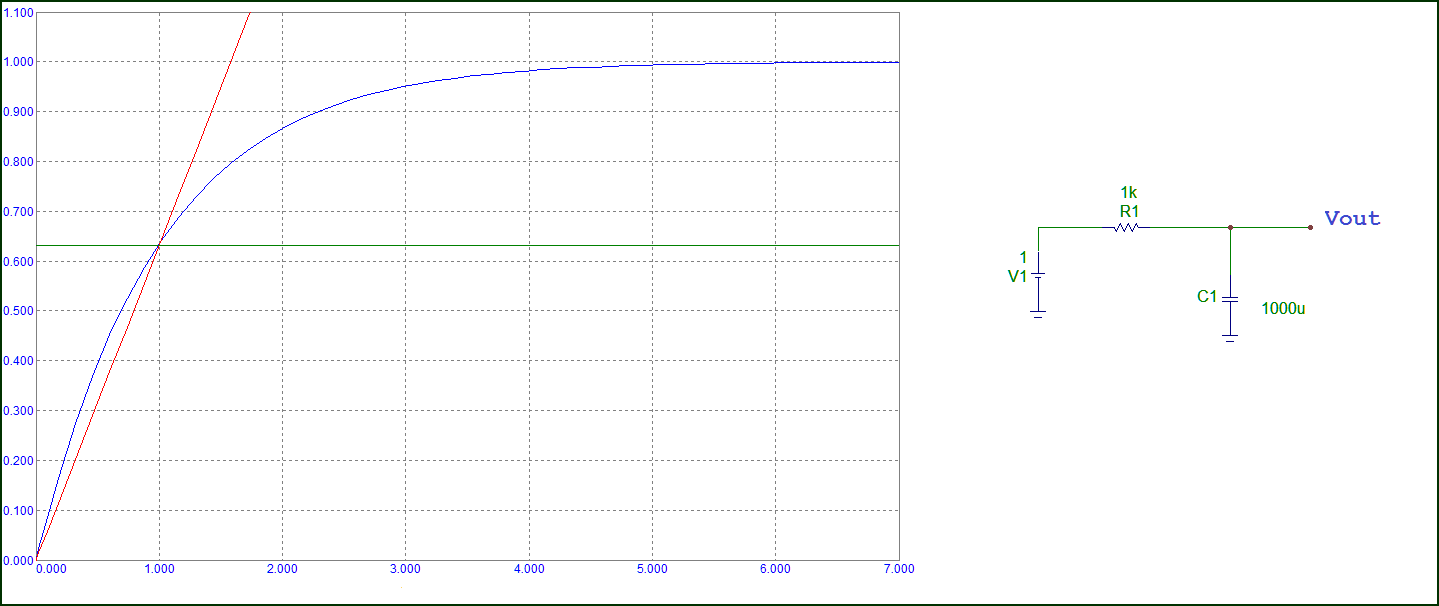

Just another thought I had: since the waveform doesn't have to be triangular (I just want the lights to fade from red to white to red continuously), do you think I could get by with an astable feeding into an RC circuit with a time constant of around 2000, and the capacitor voltage fed to an opamp with a really high input impedance?

Yes that's an interesting thought. If you use the time period of a single time constant you can get nearly a straight line ramp. How much it varies may not matter for such a low accuracy requirement application.
The idea would be to use only the first 63 percent of the total charging voltage as the ramp part. So if the cap charges through a resistor that connects to say 10 volts, that would mean just use the voltage up to 6.3 volts to vary the lighting. Once it reaches 6.3 volts, start the discharge cycle, then when it reaches near zero start the charge cycle again.
If you look at the charge curve from 0v to 6.3v you'll see it is nearly straight just like a true ramp. Not exactly the same, but close enough for this app i would bet. We were talking about something like this in another thread so i already had a drawing which i'll post here too. Note the time period from 0 to 1 second, that the red line (a true ramp) is almost the same as the blue line (the actual cap charge curve) during that first time constant period of 1 second.

I started a simulation and have something going. I didn't think of the 63% of the charging ramp though, so will adjust it for that instead. Thanks for the info.
I have plenty of components lying around for this method, so it may turn out to be the quickest way for me to get this done.
