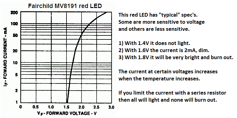

You never said the voltage (color) of your LEDs. Red is 1.8V to 2.2V and white and blue is 3.0V to 3.6V.
LEDs are not made identical. Some white ones are 3.0V and other white ones are 3.6V and if they are in parallel then only the one with the lowest voltage will light. I have a cheap Chinese flashlight with 24 LEDs in parallel so they must have paid somebody to test them all and group them into piles having identical voltages.
An LED must NEVER be powered directly from a voltage without having a series current-limiting resistor. Your experiment used the resistance of the current-meter and wires. My cheap flashlight used the resistance of the cheap battery and the LEDs nearly burned out when I used a modern battery without adding a resistor.
One of your meters showed 1.4 something. An old green LED was about 2.2V and a modern green LED is 3V to 3.6V like a white LED so your 1.4V could not be the LED voltage.

You don't need the step-down, in fact you shouldn't really use a step-down, it's quite a bizarre idea?. LED's are current driven, and MUST be current limited, so a voltage regulator really has no use at all.
It's really VERY, VERY simple - you just need LED's and series resistors - and either source or sink current with the I/O pin's, it makes little difference which way you do it. 'Personally' I'd usually source the current, unless there was some reason not to - such as a small keypad with LED that I've just been playing with, both the keys and the LED share a common positive rail, so require the I/O pin to sink the LED current to light the LED.
Most micros (ESP included) I/O pins seem to be able to sink more current than source so active low seems to be the way to go. Personally, with modern LEDs I find 20mA far too bright and run indicator LEDs at ~1mA. With a 3.3V supply you need to drop ~ 1V so for 20mA you need ~ 50 ohm and for 1mA ~1k.
Your video shows your green LED lighting when powered directly from 1.4V and you guess it will be bright at 20mA when it is fed 2.2V. But look at this graph that shows my LED is dim at 1.6V and is burning out at 1.8V. You need a series resistor to reduce the sensitivity to voltage changes:
