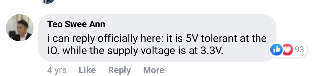

The official word from Espressif is that ESP8266 pins ARE 5-volt compatible, so you could connect the LEDs to the 5v source and remove that load from the one-board regulator.
Note that ESP32 pins are expressly not 5-volt tolerant.

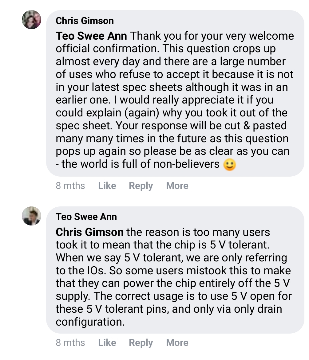

At one time Espressif, had in their documentation that the ESP8266 GPIO was 5 volt compatible. Now Espressif has removed the reference that the ESP8266 is GPIO 5V tolerant. Thus it is, to me, a matter of luck if and for how long a 3.3V device is going to work with 5 volts on its GPIO pins

Regarding 5 volt compatibility, this Hack-A-Day article refers to Facebook posts by Teo Swee Ann of Espressif Systems stating the ESP8266 is 5-volt tolerant used in open drain applications such as switching an LED to ground.
He goes on to explain that they deleted this statement as too many people were confusing 5-volt tolerant I/O pins as meaning the ESP8266 could be powered by 5 volts, which it cannot.

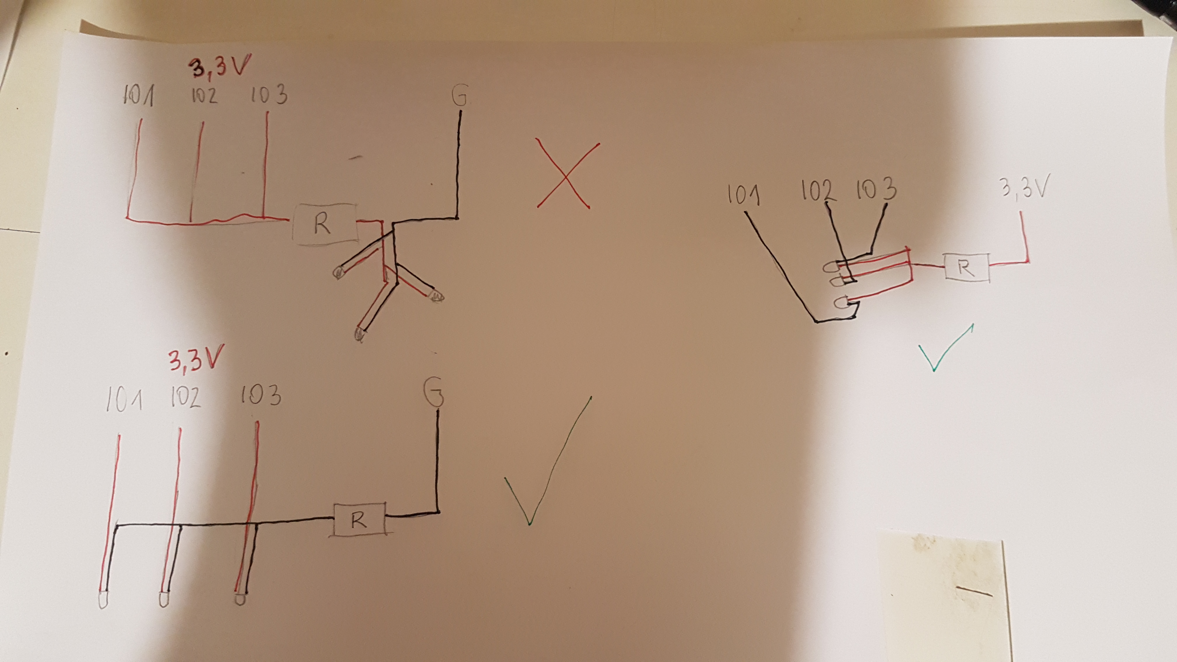

I have a few questions ...
1) I plan to power 3 LEDs from 3.3V pin on the ESP8266 board. Why ? Because that 3.3V pin can handle a lot more current than the IO pins can. And the negative wire will go into 3 separate IO pins. That way when i make pin high, there will be no current flowing and LED will be turned off. And when i pull the pin low, current will flow. And since the IO pin is connected to ground in this manner, it should be a lot less stress for the ESP8266 board as opposed to me using the IO pin to power the led and connect the negative to ground. Am i right in this ?
2) I will need 3 resistors to power LEDs. But since all resistors will be of equal value since LEDs are identical ... what if i would just use a single resistor ? So i would connect 3.3V pin to a single resistor and out of that resistor would go 3 wires, each to its own + of the LED. And then the minus from each LED would go to its own IO pin. That should work, right ?
I added a scheme of 3 situations. The top one obviously doesn't work properly since leds will be powered even if only 1 IO pin works. The bottom one should work because if you cut the + from any LED, it simply will not get power no matter what. In this situation we use IO pins to suply the voltage. And last, the right one, this is the one i plan to use. IO pins act as ground in this case and the power comes from 3.3V pin. They all share the same + pin, but since their ground is separate it should work as intended. Please correct me if i am wrong.
According to a thread on the Expressif forum, ESP8266 I/O pin capacity is:
Source: 12mA (supplying V+)
Sink: 20mA (acting as ground)
12mA is more than enough current to drive an LED, so either method will work.
You can use a common resistor for all three LEDs, provided that only one will ever be illuminated at a time. Seems like a lot of flexibility to give up to save the cost of a couple resistors.

What do you mean by a 'step down'?, if you mean a switch-mode converter it's somewhat more complicated than a single resistor? - which you would still need anyway.
But you generally shouldn't put LED's in parallel, except under certain circumstances, and using identical LED's.
