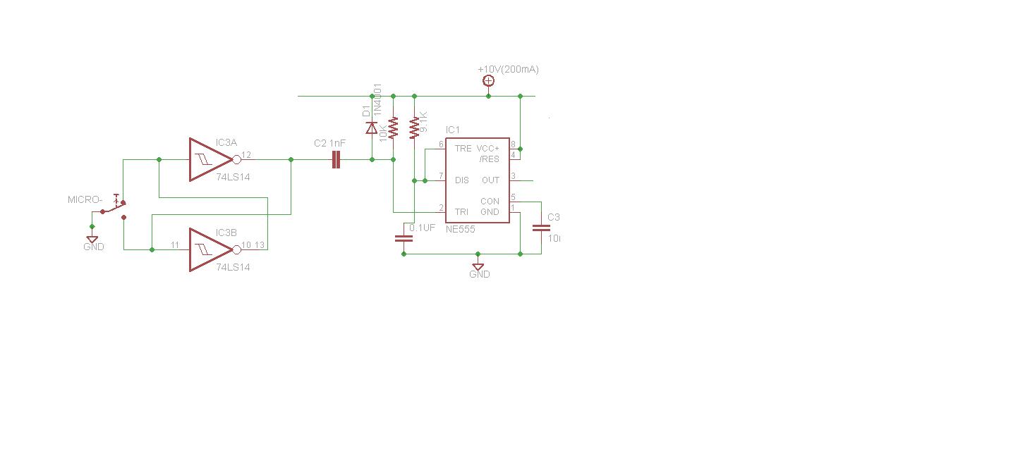

As shown below, the output of the differentiator is only -ve going spikes which are already less than Vcc/3. Hence 4Vpp wouldn't be a problem.
You don't understand.
Pin 2 is normally at 10V, held there by the 10k resistor in your full schematic (with the 555). Pin 2 must go below 3.33V in order to trigger the 555. 10V-3.33V=6.67V. That is why I said you need a pulse that is at least 7V p-p.
OK I got it.

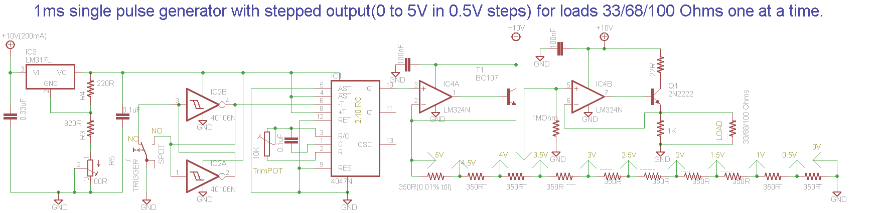

If I have exact 5V at top of ladder (by the use of zener to clamp 555 output at exact 5V), then resistors of the ladder should be have 0.01% tolerance levels for equal divisions of this 5V.
My doubt is then the 50K in parallel with them could change the balanced condition of the ladder. Thus no equal voltage divisions takes place. Can I avoid this by placing 100K or 1M ohms (>> 1K ladder) in place of 50K without disturbing both ladder and the op-amp.
If I avoid POT and connect op-amp directly to ladder , then floating condition would be resulted between switching intervals of ladder outs.

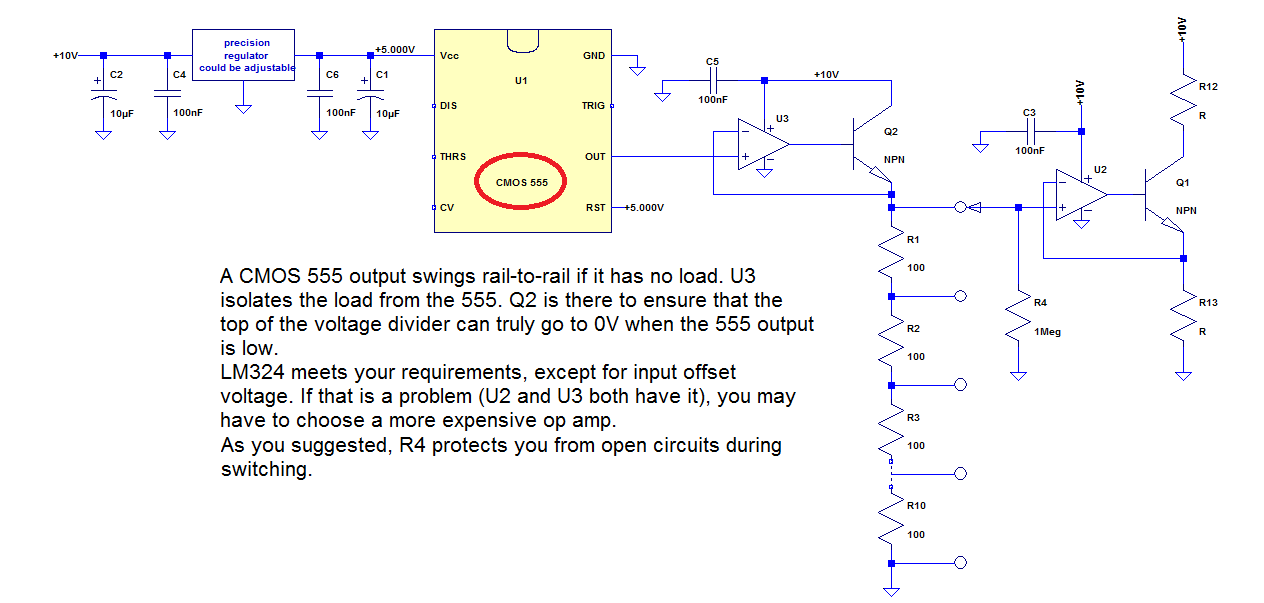

You can buy rotary switches, and possibly analog multiplexers, that have make-before-break switching. Are you using jumpers to switch the voltage divider? If so, then I think I would do it like this.
See the attachment.
See the attachment.

1. How Q2 can ensure that the top of the ladder truly goes to zero when output of 555 is low ? As it is in emitter follower mode, the top of the ladder (emitter) directly follows the Base input.
Here base input is (out of 555 + 0.7V). Thus at the top of ladder voltage is (out of 555 +0.7V - 0.7V)= out of 555.
Based on the above fact, top of the ladder following even the small changes at the output of 555. That is below 0.5V. (lower limit of required output pulse)

Without the emitter follower on U3, the top of the ladder could only go as low as the saturation voltage of U3, which will always be greater than zero volts, especially if you are using an LM324. With the emitter follower, U3 can go low enough to completely cut off the emitter follower, assuring 0V on the top of the ladder. You still have to use an op amp that can swing within ≈0.5V of ground.

Because CMOS logic outputs swing rail-to-rail. If you connect 5.000V and 0.000V to the supply pins, the outputs will swing between those voltages, providing there is no resistive load on them. TTL outputs do not swing rail-to-rail, nor does the output of a bipolar 555.

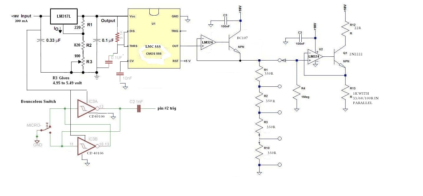

Output of CMOS 555 is only 4.7V at 5V supply ! But I want 5V at output.
Can you suggest CMOS equivalent of 74121 ? I think CD4047 outputs 5V(typical with min value of 4.95V) at 5V VDD supply.
Can I use any resistor network ICs to simulate the role of good tolerance resistance ladder ?
Can I use any analog MUXs to switch voltage levels from 0 to 5V in 0.5V steps between ladder and output driver transistor ?
Can I use Make-Before-Break contact having NOT latch instead of debouncer using capacitor across the switch as shown below?

I got it from the datasheet itself.
The datasheet shows a small voltage drop when the output has a load current! But your Cmos 555 is feeding the extremely low input current of an opamp and the opamp might have Fet inputs which have NO input current.
The datasheets say:
1) The LMC555 has a typical output of 4.7V when its load is 2mA.
2) The TLC555 has a typical output of 4.8V when its load is 1mA.
3) The ICM7555 has a typical output of 4.3V when its load is 0.8mA.
Their outputs are rail-to-rail when there is no load current.
using LMC 555

I have made the following adjustments in your schematic...
