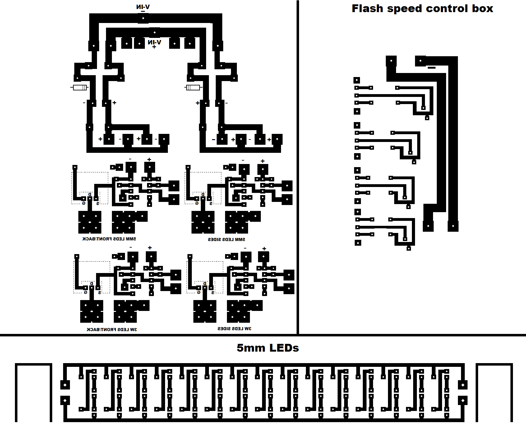

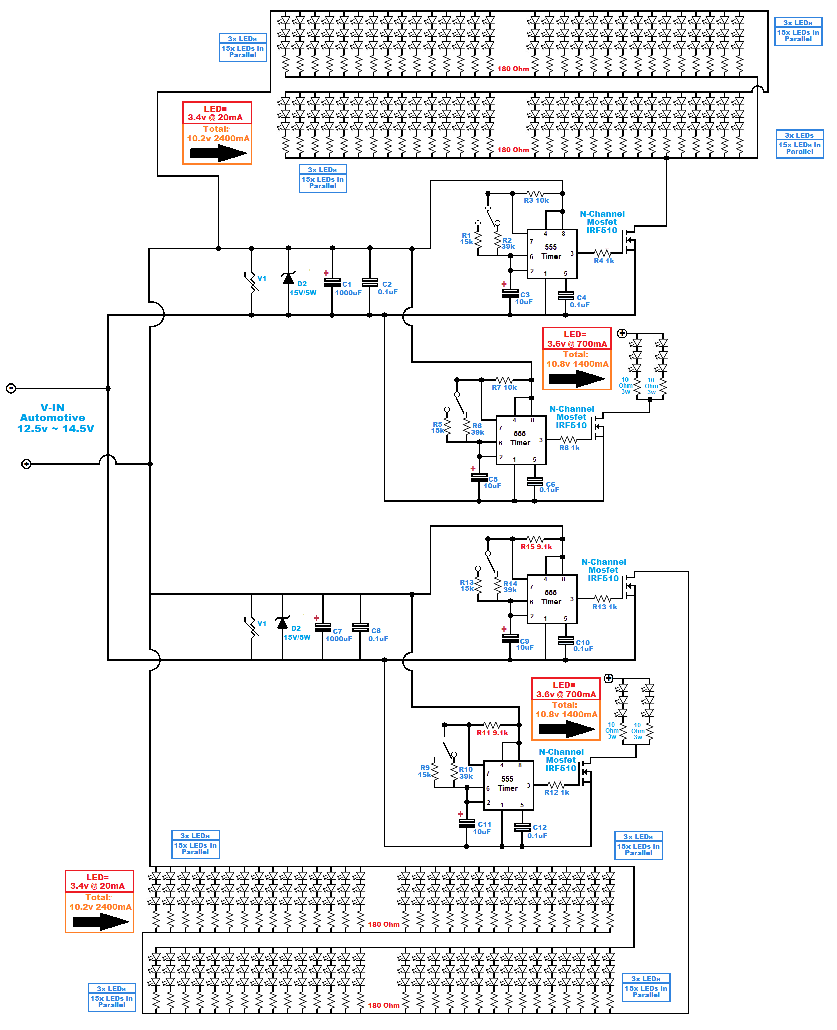

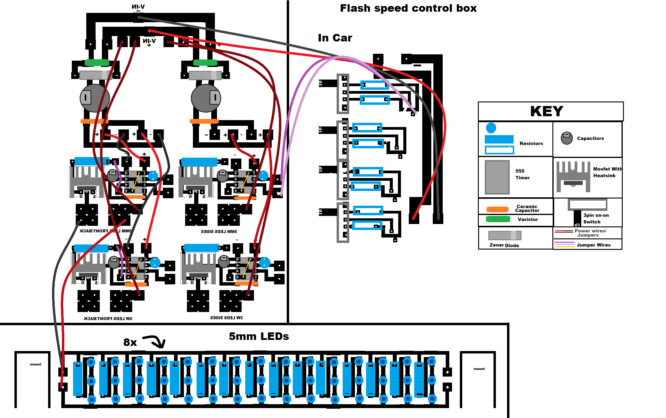

Hello my name is cody this is my first time posting here on this web site.
I need a second opinion on everything I've got drawn up here so I don't go off and blow up all of my parts when I test all of it out.
I've been trying make a mini light bar to be used on my vehicle for awhile now. Using bunch of 555 timers and 5mm leds along with 3watt leds you would find off Ebay. I have a good understanding of all the parts I'm using. But I'm sure there is a mistake or something not right in my circuit. I have tested few parts of the circuit on a test board but not the whole thing all together (No Room)
Photos below are of the schematics, printed circuit board, other

In barlayout16 half of your LEDs are reverse biased :(.
I recommend you find a mosfet with a lower rds. With the IRF510 you will have up to 1.4V drop across the source to drain, causing less voltage to the LED's and some heat loss.
Thank you

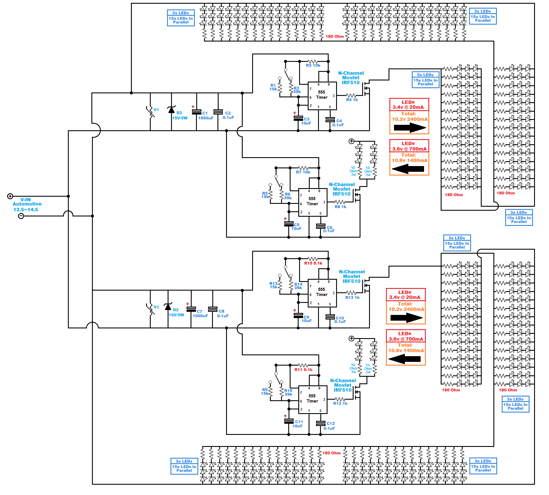

Sorry about the error in the photo mini light barlayout16.
I didn't notice I had the symbol for the LEDs drawn backwards >.< they not supposed to be.
All of the 180 ohm resistors are going to the cathode of the LEDs.
Other than the backward LEDs and the rds/mosfet. Anything else that is wrong with the circuit?
I'm going to few stores today. Is there and mosfets you know of that I should keep an eye open for?
The LEDs are not simple incandescent light bulbs. They will have a range of forward voltages so some will have too much current, be very bright and will burn out soon, and other will be look dim.
How will you cool the LEDs and resistors?
Why do the timers blink the LEDs on and off all the time? Are you pretending to be an ambulance or a fire truck?

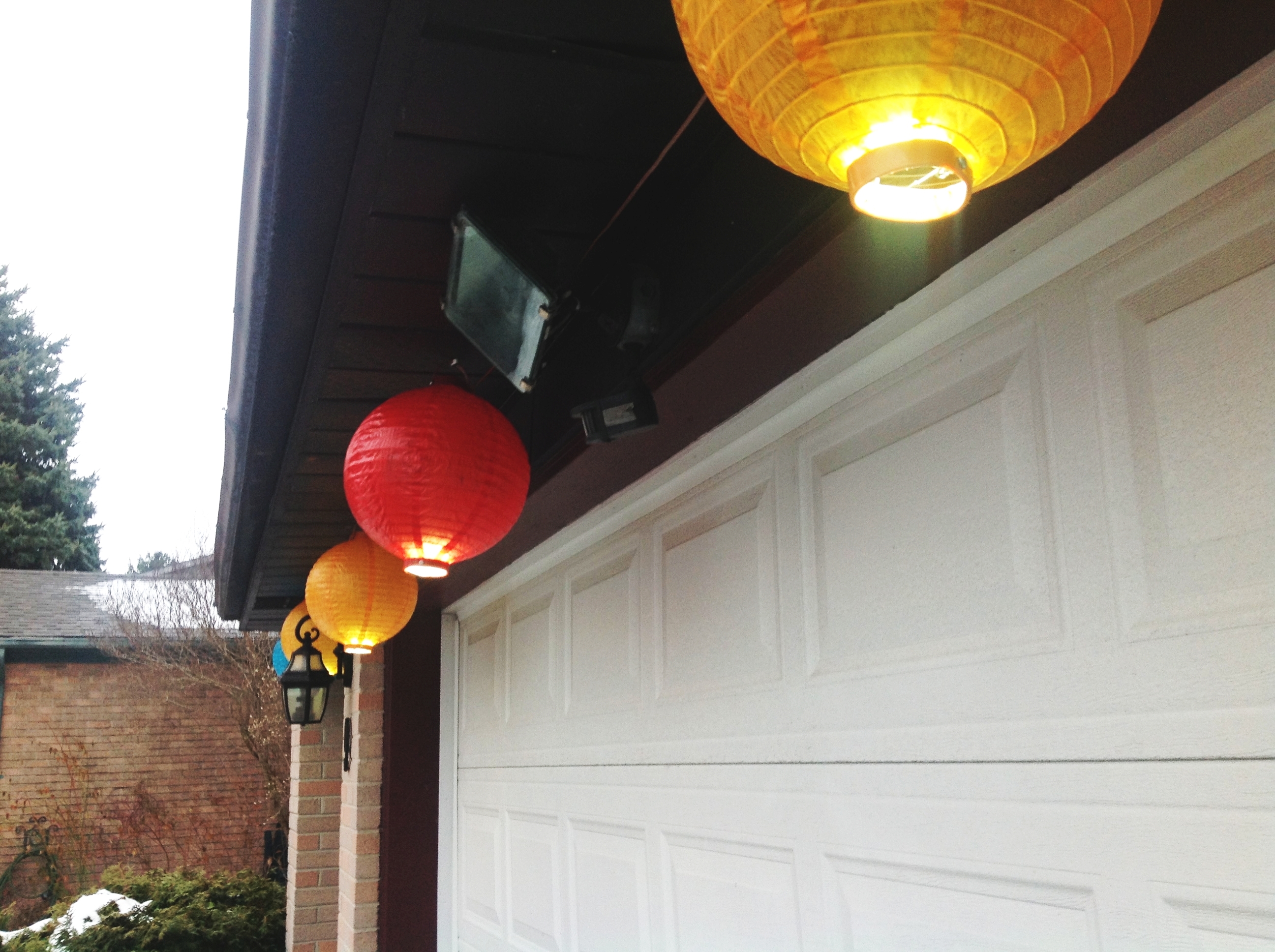

Below, for example these I made using paper lanterns ( plastic coated) with 4 LEDs cut from large board into 2"x2" square,
These are running at you might call DIM at 12.0V DC regulated brick drawing less than 2A total for 20 LEDs. If I ran at full power they would be as bright as an Ambulence Light, which is what they were designed for.
4 LEDs in series Rs=0. and 5 Lamps in parallel or 4S5P array and boards running cold under/inside shade, Wired with 30 AWG magnet wire inside to 18AWG speaker wire along eaves soffit is convenient and also prevents thermal runaway with 50~100mΩ added ESR.
