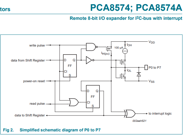

Like what? The one I pointed to has a bit for each pin to make I or O and also a bit to invert the logic. Some expanders have pins that are both I & O at the same time and that can be hard to understand.

At the same time? Both in and out? Explain.
It is open collector (more or less) with a very week pull up. So from the compute side you can write a 1 or a 0. But to read you need to set that output to 1 and let the thing you are looking at pull down.

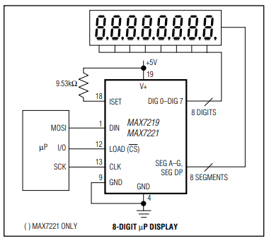

Last time I did a large LED display I used shift registers and in a matrix. I think the matrix was 8x? so each LED is only powered 1/8 of the time.
Just a though. Here is a IC that drives 64 LEDs. I have seen boards with two of these and 128 LED on one board and then you can chain many boards together.
This sounds like analog-style circuitry vs what Dana has suggested (more of a modern IC solution).

You need to explain that. Or is it simply OC?
Some (most) IO expanders can be set to OUT or INPUT.
Here is how old IO expanders work. There is no bit to set to make a pin an output. It is not quite like Open Collector but close. (much like the old 8051 IO) P0 to P7 are the IO pins. There is a MOSFET that pulls down hard but the top MOSFET can only pull at <100uA. So it is much like a Open Collector with week pull up resistor. To make a port a "input" you need to set the pin to 1.

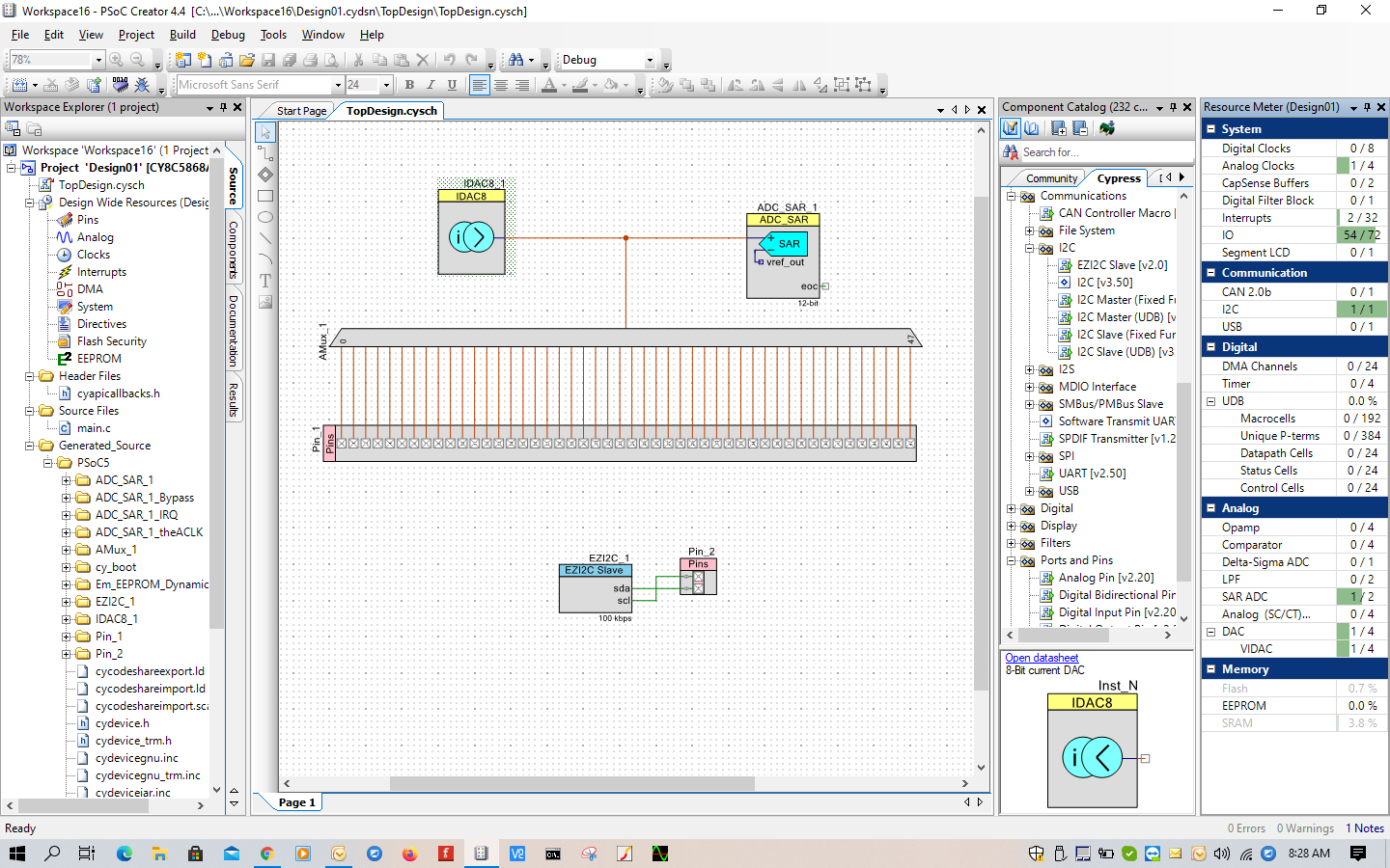

If you do plan on analog as well I was able to get this PSOC to route to 48
analog channels. Mux feeds 12 bit SAR. Note IDAC also can be used to force
current out of pin for force-test pin status. IDAC can be either source or sink
under program control.
Also used was a I2C slave component to transmit to your host CPUs. Note in
PSOC land a component is an onchip resource.
Design is single chip. I tried 64 channels but would not route. You might be able
to do 50+ channels, you would have to try it out. I also did not try PSOC 6 (this is
a 5LP example), which has more pins, you could try that as well.
So this would save a lot of chips, eg. many external analog muxes the alternative as well
as DAC and ADC chips you would need with your current approach.
If you decided not to use the ST parts keep in mind this chip can enable both analog
and digital on the same pin. So 5 5LP chips would do everything I think for 240 channels.

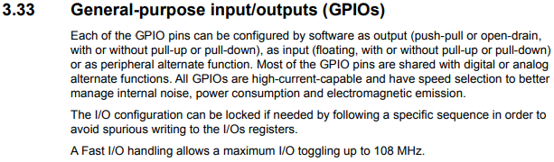

So I was looking deeper into potentially using the STM32F730I8 micro and got a bit lost about it's GPIO's.
The datasheet says:
As the input or output can have either pull-up or pull-down or even no resistor at all, is there any benefit from adding one, especially when same input will be input and output at some point of the test program? I might have read too much various information and started to get lost now..
The datasheet says:
The only benefit of adding one is if you need a completely different value, but usually the value isn't important at all, so just use the internal ones.
