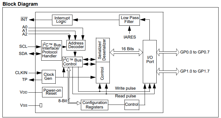

MCP23016; there is a thing called i/o expander. In this case it is I2C but there are SPI versions and parallel versions. This one is 16 bit but there is a8 bit version. This part you can set each pin as I or O. By using A0,1,2 you can have 8 devices on the same bus.

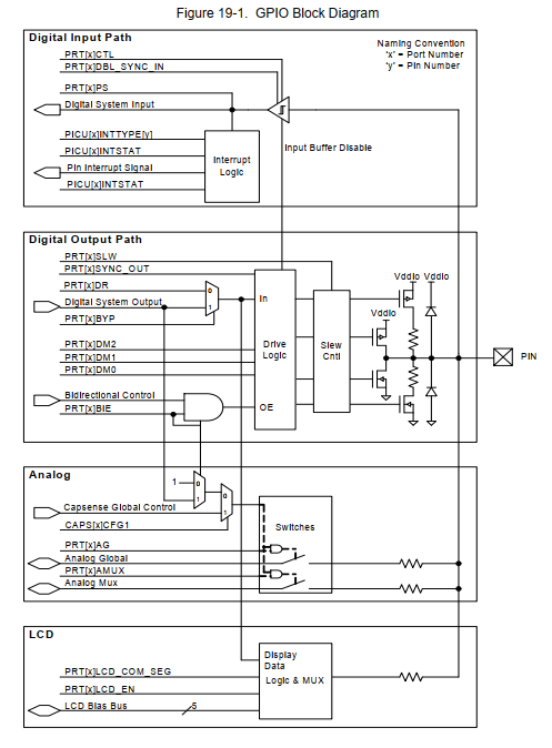

Most modern processors can config a pin to be bidirectional. Using internal
pullup pin can drive out, and its input register read the pin by driving a 1 onto
pin and reading if its being pulled down by external driver.
Note in some parts pin can function both as analog and digital. Leads to some
interesting design possibilities.

IO expanders it had some limitations
Like what? The one I pointed to has a bit for each pin to make I or O and also a bit to invert the logic. Some expanders have pins that are both I & O at the same time and that can be hard to understand.
