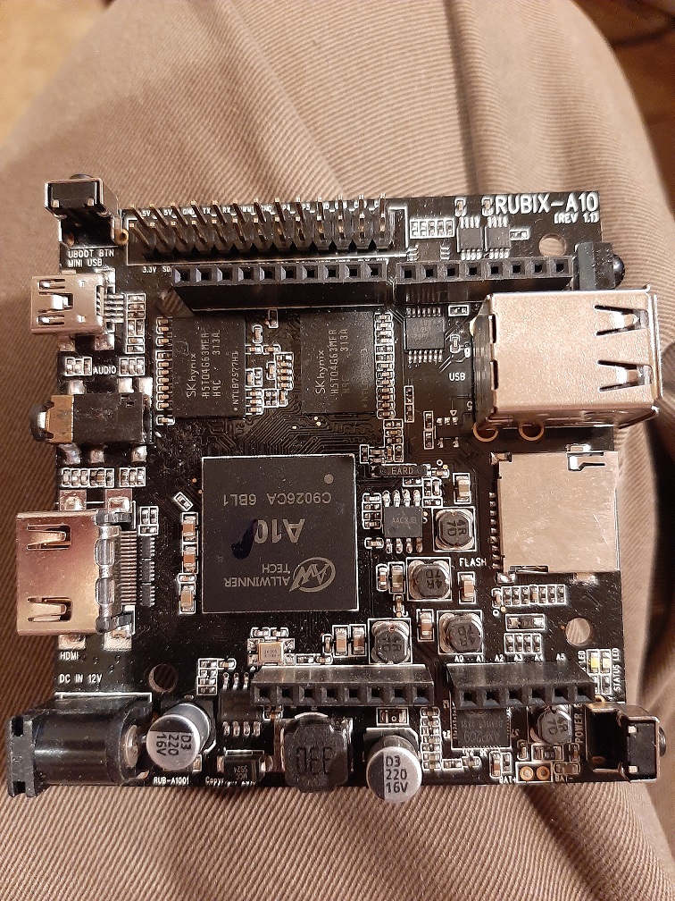

I got a brand new SBC with the A10 on it booted one time and some how killed the boot files
I was reading that it was a problem with the way it was booting off a flash chip if the power dies before booting is done
it can write back over the boot block which it did. LOL
I give up on it till I have more time I made a boot.img for SD witch the A10 can boot from but as now I not made it happen.
Read up over here https://raymii.org/s/articles/Olimex_OlinuXino _10 Lime_uBoot_Kernel.html
I have a Rubix A10 it's a nice board but the thing has no support you can find stuff yes but all the links are dead
to like the recover .img
I got it for like nothing at a hobby store it had been returned the uBoot.img is what it's called is messed up I had a very limited liunx setup on it that let's you program arduino it has the same pinout but I built 3 uboot.imgs couldn't get it to boot I maybe play with it some more now i have more time.
Let me add I did boot it one time LOL then the uboot messed up I read where if you kill the power you mess the uboot up
my guess thats why I got it for nothing to begin with It's come's on and just wait's to boot
