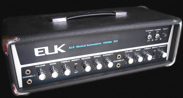

ELK VIKING 103 Guitar amplifier
diy didi
HI Guys.
I'm in need of a schematic for this Solid state guitar amplifier.
Someone's been in here and really messed things up. Any help will be much appreciated!!
Maybe another ELK solid state schematic will be close enough if you're willing to share.
Thank you!
HI Guys.
Thank you!

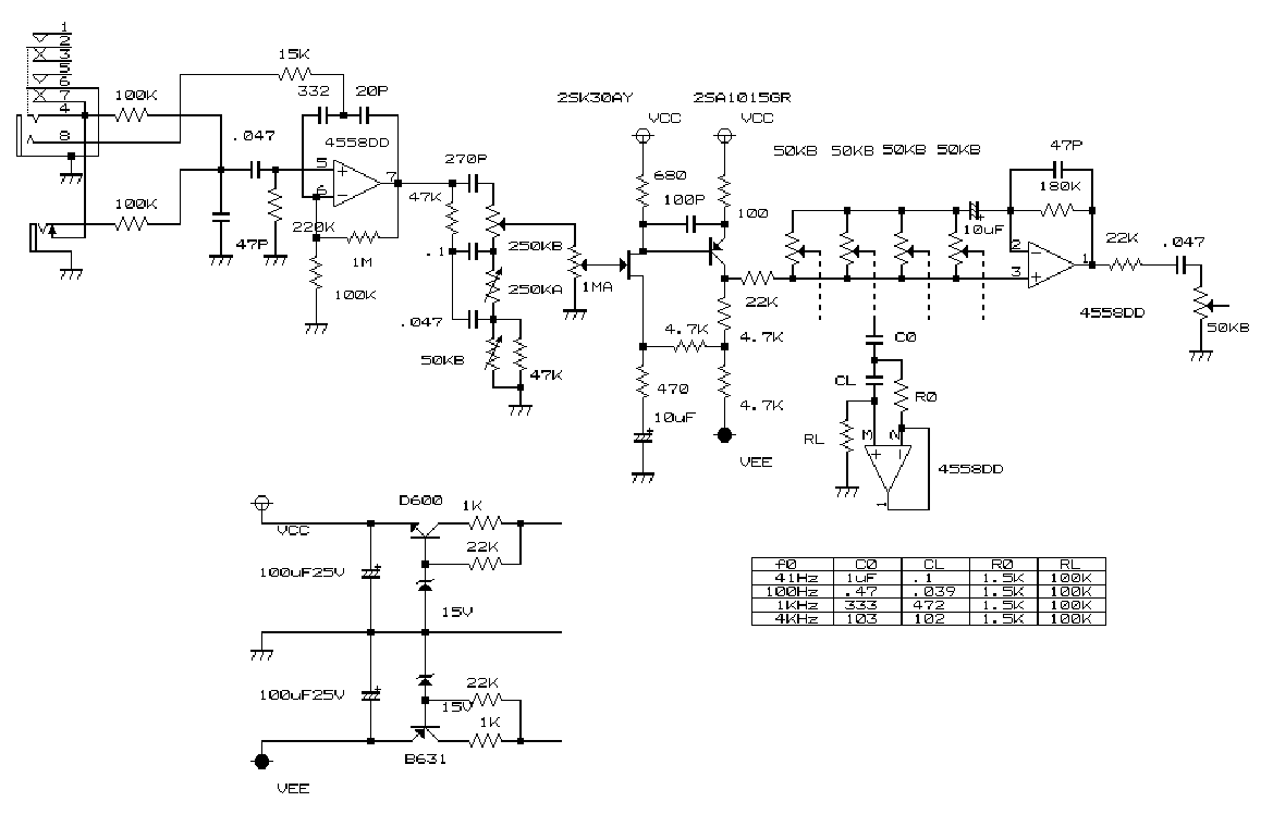

Just a long shot (front end only):
