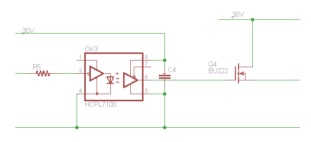

The opto gate driver spikes to VDD for 5 to 15uS at power up and power down, in the same way a monostable multivibrator does if the reset is not held low during power up. So turning off the opto causes the same problem as turning it on.
The opto won't create a pulse on power up. It has a circuit that keeps it's outputs safe until the voltage is 13.5 volts. Since we don't know what the whole circuit looks like it is possible that the 30 volts is on and the opto is being told to turn on by the circuit that drives it. Running the opto and the FET at their maximum rating is not a real good idea anyway, so maybe if you have 15 volts somewhere you can use that and power your other circuit from that as well.
Having said all that if there is no voltage on the drain unless the 30 volts is blowing them something else is wrong.

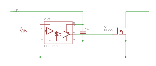

Bottom half:
This MOSFET pulls down very well. Does not pull up at all. The G-S voltage should be in the 10 to 15V range. 20 absolute max.
The Drain voltage can be very high (if the MOSFET is rated for it). The voltage can be almost anything and is not effected by what the +12V is.
The MOSFET turns on when the G to S voltage is more than 3V. (depends on the part).
In this case the gate voltage (compared to ground) goes from 0 to 30V.
So the MOSFET-S will go up to about 27 volts and no more. If the S gets any higher the transistor turns off.
The D could be at 300V but the S is at 27.
This is not the way!

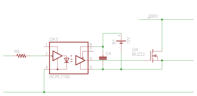

This is the way to drive the top side.
Note the 12V battery.
The isolator/driver is connected G-S and applies 0 or 12V on the G-S. It is not referenced or connected to ground in any why.
When on the driver applies 12V from G to S. The D=300, The S=about 300,
The gate is at 312 volts. The battery is connected to S (output).

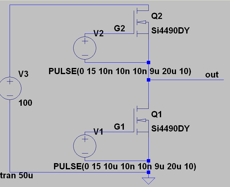

Here is circuit. V1 and V2 drive voltage from G to S of the MOSFETs. 100 volts is the power supply.

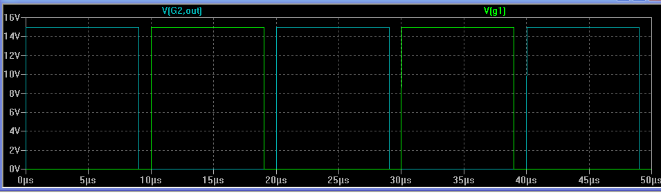

Here is the G1 signal and G2-S2. (G2-out) Notice I do not have both transistors on at the same time. There is 1uS of time when no transistor is on.

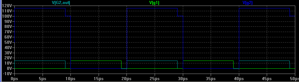

Here we see G1 which is 0 to 15V, G2-out which is 0 to 15V, and G2 which is 0 to 115 volts. (because the Gate and V2 ride on "out".
Here I added the red trace which is "out".
