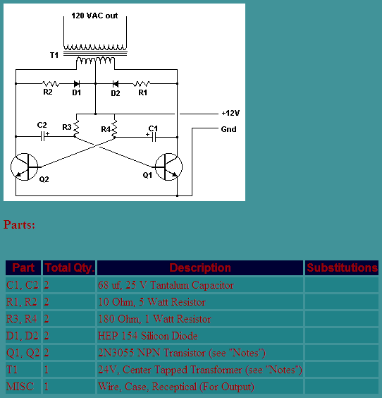

Aaron Cake has some faulty projects on his website. One is a 12VDC to 120VAC inverter that has its timing capacitors backwards so they blow-up. There are two very long threads with complaints.
The inverter's output is about 25W before they blow. Reversing the capacitors also causes then to blow because the two power transistors have avalanche breakdown which feeds them huge current pulses. The transistors have hardly any base current.
The horrible Moderator said the inverter project works fine.

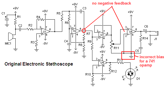

Like the opamps in the defective Electronic Stethoscope from Aaron Cake and copied to Electronics-Lab projects.
He said the opamps were fine and he has e-mails from people who also said the project worked fine.
