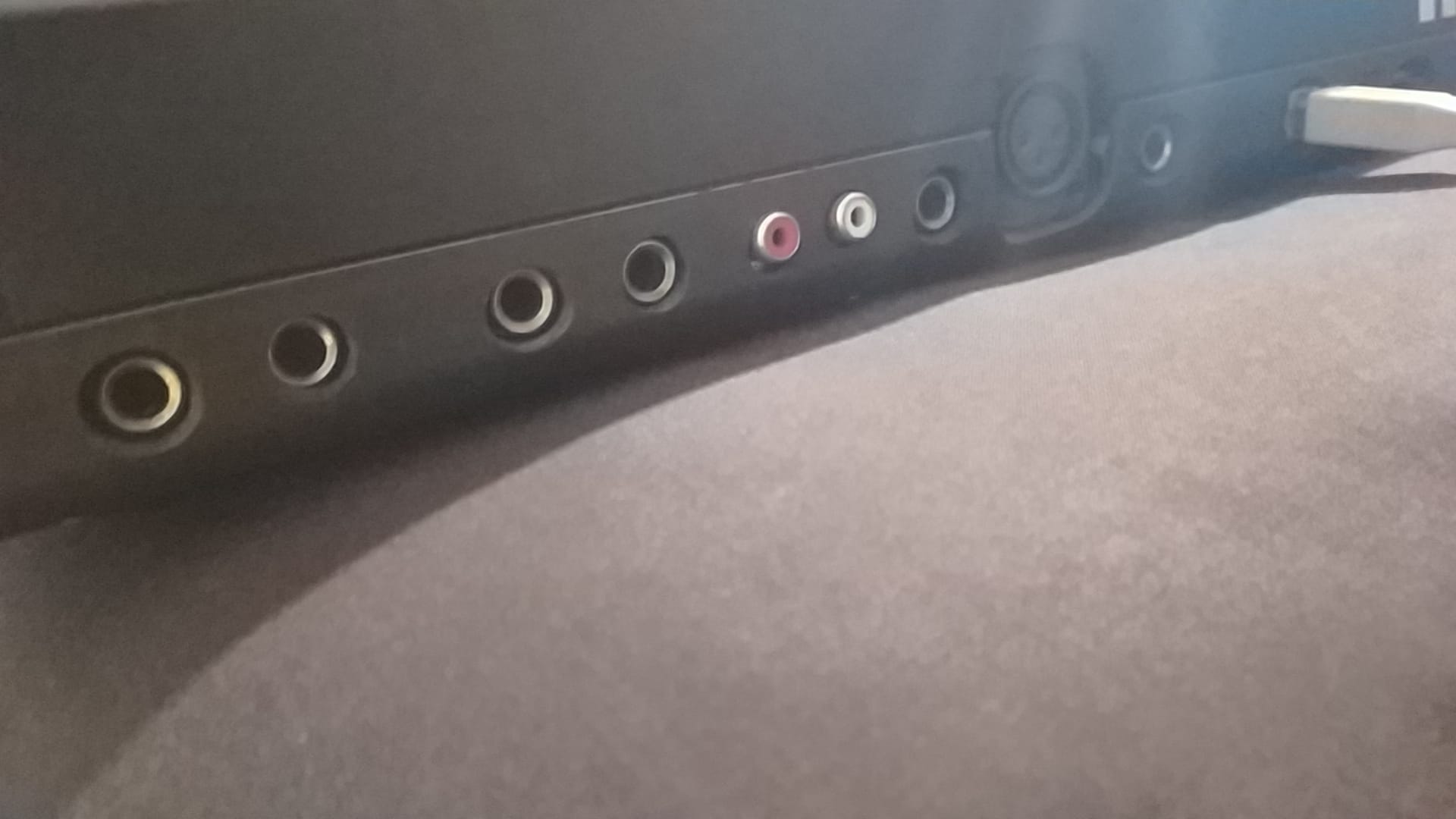

Yes on the Sono 88 the USB (port at least) is on different board to the SAM3308B. It's next to the the other ports on the back of the unit. Here's a photo of the ports board from the Sono 88 which I have installed now in the Origin62.

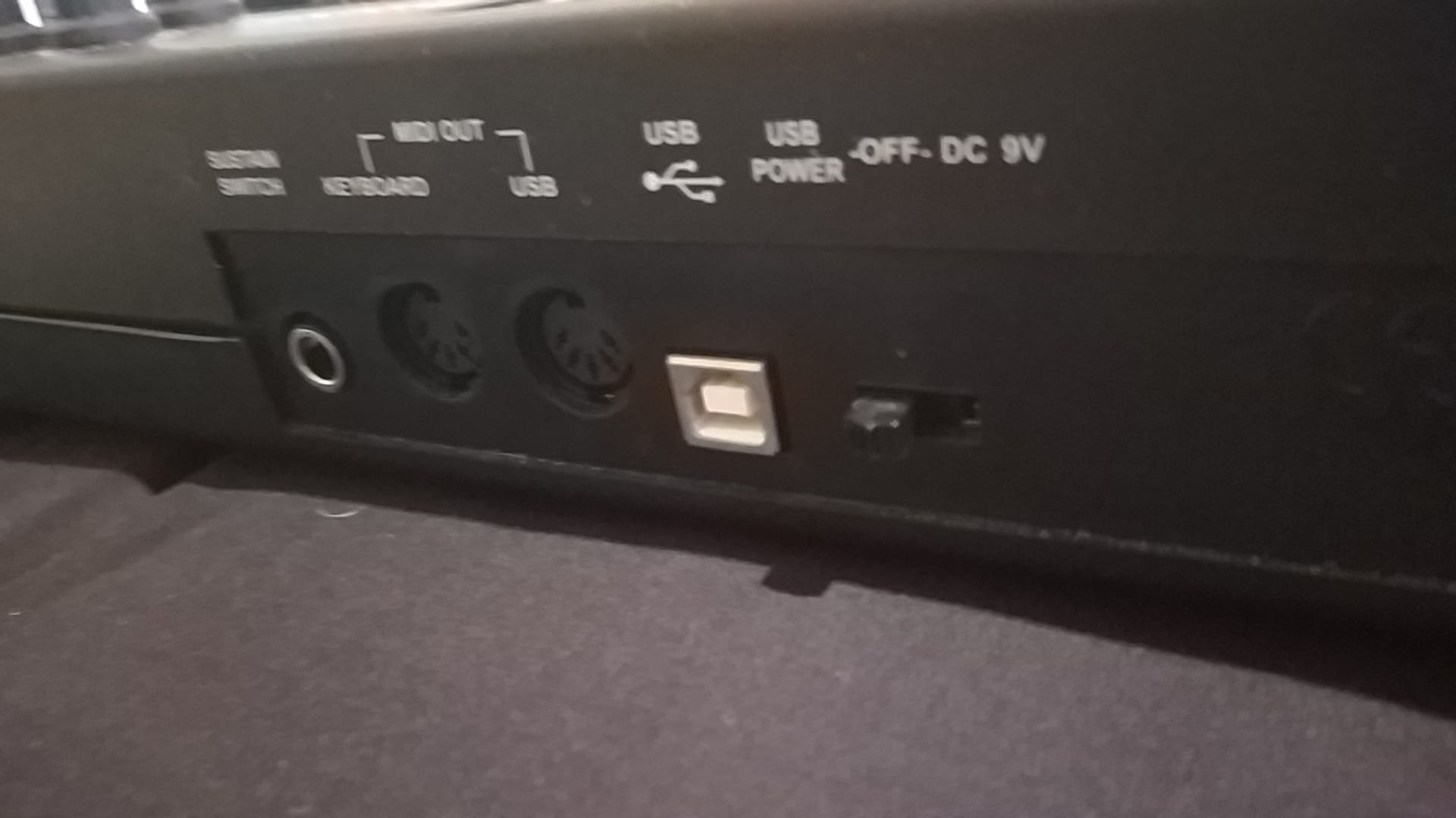

The ports on the Origin62 are down the other end.

I think I have given the wrong idea there. One of my two goals is to get midi coming into the Sono 88 interface via a DIN midi connection which I could install on the back of the unit. I don't need a solution for Midi into the Sono 88 interface via USB as I can already do this. I send the midi either from a host (pc , phone, etc.) to the USB input of the Sono 88 interface and it receives Midi that way. Or, using a host to just relay midi coming out of the Origin62. But those two setups require a host and I can avoid that if I install a midi input connector and get that going into the SAM3308B chip. That way I just need to power the units and connect a midi cable from the Origin62 DIN Midi output to an installed DIN midi input, which goes to the SAM3308b chip.

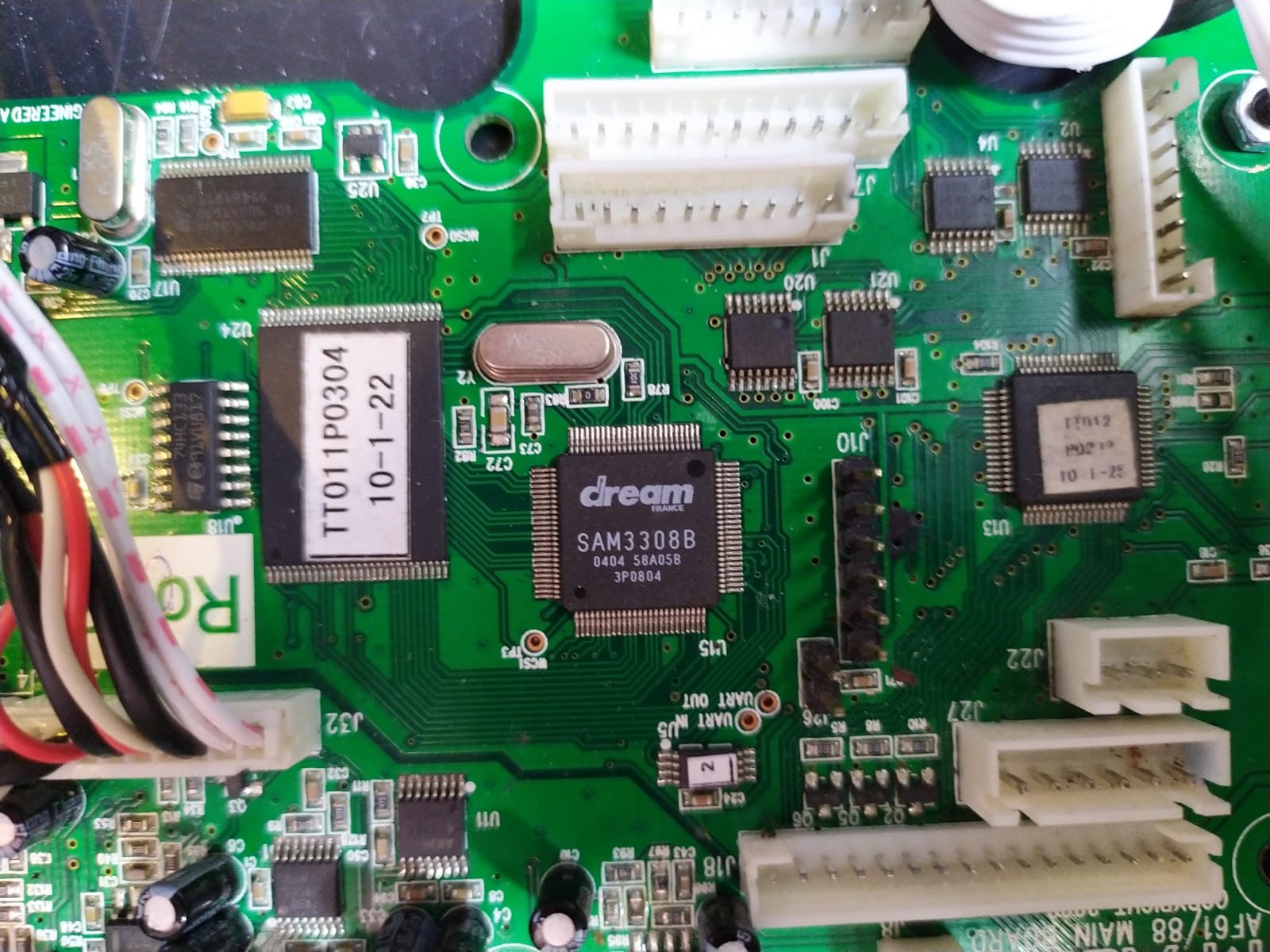

7 and 17 are unused. There seems to be a trace out of 7 with a hole. Presumably that's good because it's easier to tap into, right?

It is a programmable device and some pins are programmable depending on what the system designer decides in most appropriate.
From that photo, pins 17,18,19 & 20 are all without obvious topside traces, but there could be VIAs or craces back under the IC body.
Interestingly there are two test points just across from those locations labelled UART IN and UART OUT; they could be connected to 17 & 18 for diagnostics or monitoring MIDI data in & out?
OK I have checked with the multimeter and 17 and 18 are indeed connected to those UART IN and OUT test points. Would I now need to test whether feeding Midi signals to UART IN produces anything?
