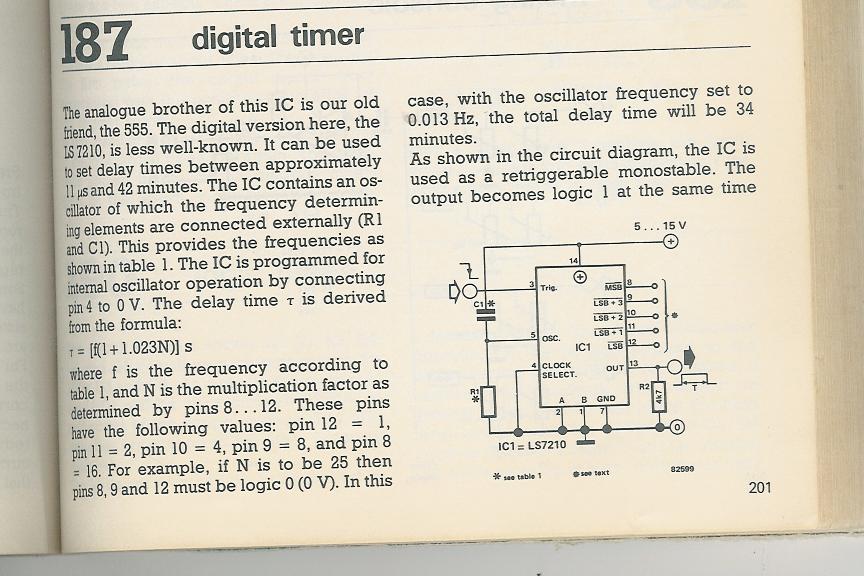

that is one uncommon and expensive IC, is is new or old? the company seems to be N.Y.C yet only available from China? very interesting though. took a quick peek at the data sheet, and looks promicing. I looked to the top US suppliers and no avail.
its uncommon and old, i checked it on ebay $ 5+4 shipment, not cheap. but it can suit to your applicaiton.
i have bought ICs on alibaba.com and cheap, check the below
https://www.alibaba.com/product-gs/541073947/LS7210.html
Razeen, ...............I am a wee bit overwhelmed by the data sheet, to be honest..... what are your thoughts on a digital pot (say non -vol with up/down?) or dual? I am concerned about simplicity? trying keep components to a min.
the dea is you can make a programable pulse generator by inserting this IC in between. instead of using a digital pot and set your values to the oscillator, you can use this in loop with an osciallator to give a range of frequencies. let me see if i can post you a simple CCT when i get free time
I kind of understand what you are saying, but how is it going to be adjustable on the fly? as I understand the freq. is adjusted through 5 digit binary. I dont want to fiddle with switches or use a P.C. to run the binary code. I assume the fixed speed is the external 555, and the adjustable is the internal clock controled externaly some how?
you discussed about digital pot, so i assumed your inputs are binary / logic. what are your control inputs? you need to have only two speeds? or variable on both directions? the IC provides programable delay, as well as can be used as a variable frequency pulse generator as you think. i didnt use it for any application yet, this is what understand from the datasheet. also you can use it with a astable multivibrator to delay the change of state so that can get different frequencies too.

A digital pot can be used as a rheostat, but there are a lot of details to attend to. Low-cost units have huge resistance tolerances, like ±20-30%, and resistor tempcos of 200-300ppm/°C. You can buy low tolerance, low tempco units, but they are relatively expensive, and have peak current specs that have to be adhered to.
You can use a low-cost unit for your application in ratiometric mode, which is what they are designed for, but it would require more parts, like an op amp, a transistor, and a couple of resistors.

You are using stepper motors and the way to control the speed is by controlling the pulse rate. I advise you to give up the idea of having a variable frequency by controlling the oscillator instead you can use a counter to divide digital clock / pulse from a fixed squire wave generator. The division can be set manually by simple section or even can be by logic inputs.
Also you entire circuit can be minimized by removing limit switches since you can exactly control the no of pulses delivered and reverse the motor after a short delay. So it’s not necessary in this case to have two different circuits. Say you have to give 1000 steps / pulses to move from “home” to the destination. Then stop for few more pulses depend on the time delay required. Then reverse the motor the same signal would re-direct your pulses through dividing counter giving you a longer time for the system to return home.
It’s in my mind how it can be done as I described, try if you can work it out, if not I can give you some sketch.
Limit,HOME...... Yes that would work, however It must always know where home is....... on startup .or mid-cycle start.......cannot assume always at home position. like a printer. cycle on..... find home....... all values assumed after that 1000 steps is 1000 steps. I understand what you are saying but is this possible without a microcontroler? as I said efore I am running this currently on a cnc program called MACH3....I bought a PIC programming book, but without personal help it is way to complicated for me to understand? I have looked at basic programs and others, I wish I understood them?....... thats why I am trying to do on off type circuit? and yes Idealy I could adjust the pulse rate and number.........and if pigs could fly.....a ramp up frequency on high speed.\ for return to home/ the more I try to learn, the more I undertand that I don't know....
