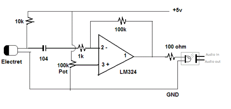

On the following circuit I can control audio source volume depending on the sounds capture by the electret. I used it as a breath controller. (there are other components on the audio in/audio out path but in essence this is the complete circuit). The Led glow more or less depending on the electret capture sounds/breath.
Requirement : What I need is to add another LED + LDR (optoisolator) and make it behave the opposite as the first LED + LDR. Which means that the second LED will be lighted all the time and will reduce its intensity once the electret capture sounds. I will wire the two cadmium sulfide photo cells in series, which will give me 3 contact points, which I believe can substitute a potentiometer. How can this be done?

Hello,
If you run a constant current through two LED's in series they both light up about the same brightness.
If you shunt some current around one of the LED's that LED will grow dimmer while the other grows brighter.
Perhaps you can use that as the mechanism to change the resistance of two photo cells.
The current shunting might be done with a transistor or a third (single) photocell and LED.pair.

If you're happy with the circuit you've given for one LED, then simple duplicate it and either change the amplifier configuration to non-inverting, or connect the LED and resistor between 5V and the opamp output.
