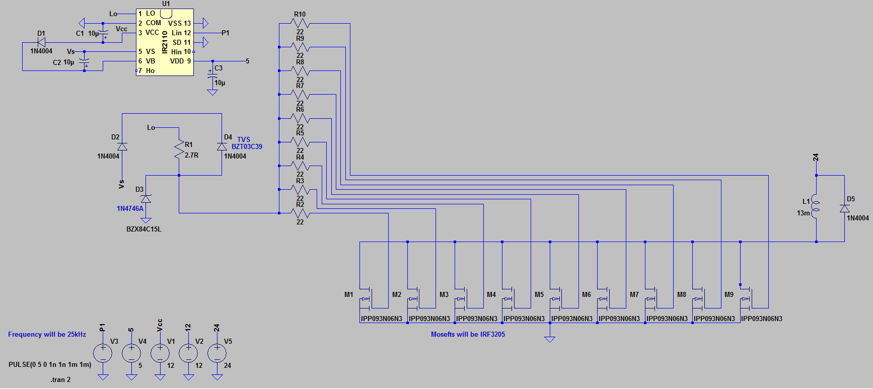

I have drawn a schematic that seems to work ok in LTSpice?
I found some IR2110 chips yesterday & have tried to use one & really I am not sure how I went except for the simulation.
I thought I may as well try to make it handle a bit of current & have a 24V source in the simulation, at 150A it seems ok, to me that is?.
I have attached a screenshot & the sim file.
Anyway, see how I went?
I lowered the Gate trigger frequency so the simulation runs faster, it's pretty slow on my computer at 25kHz.
There is also a few LTSpice Models I don't have so I just used what I had?
If any one has the Models I would like to get them?
Cheers

I wouldn't w0rry about running the PWM frequency all that high. Given the huge amount of inductance that a electromagnet that size has a few dozen hertz is still plenty fast.
To be honest I don't see why most any basic off the shelf low voltage speed controller like the ones used on smaller electric vehicles or battery powered equipment couldn't be used to do the job.
Most variable speed controllers from a common cordless drill or such tool are capable of driving much larger capacity switching devices that what are used in the tools without any modifications at all other than switching out the original power mosfets for a larger set.
Just my thoughts.

I haven't run your simulation as I don't have a model for the IR2110. What do you see the current through D5 as? What is it's power dissipation?
The reason I'm asking is that, the current through the free wheeling diode will initially be the same as the peak current through the inductor and the mosfets. And, depending on the duty cycle of the pwm, the power dissipated in the diodes can be higher than that dissipated in the mosfets.
The free wheeling diode also needs to be a fast switching diode such as a schottky part.
This is an electromagnet built out of high loss soft iron alloy material that if it's having a really good day might reach tens of volts per millisecond voltage rise rates when the circuit is opened nothing like a ferrite core inductor in a SMPS that could have KV's/uS voltage spikes.
Any half assed power diode with a several tens of amps current rating would be more than sufficient for the free wheeling circuit.

A flyback diode or r/c is enough to damp back emf on a lump of iron, tcm's right.

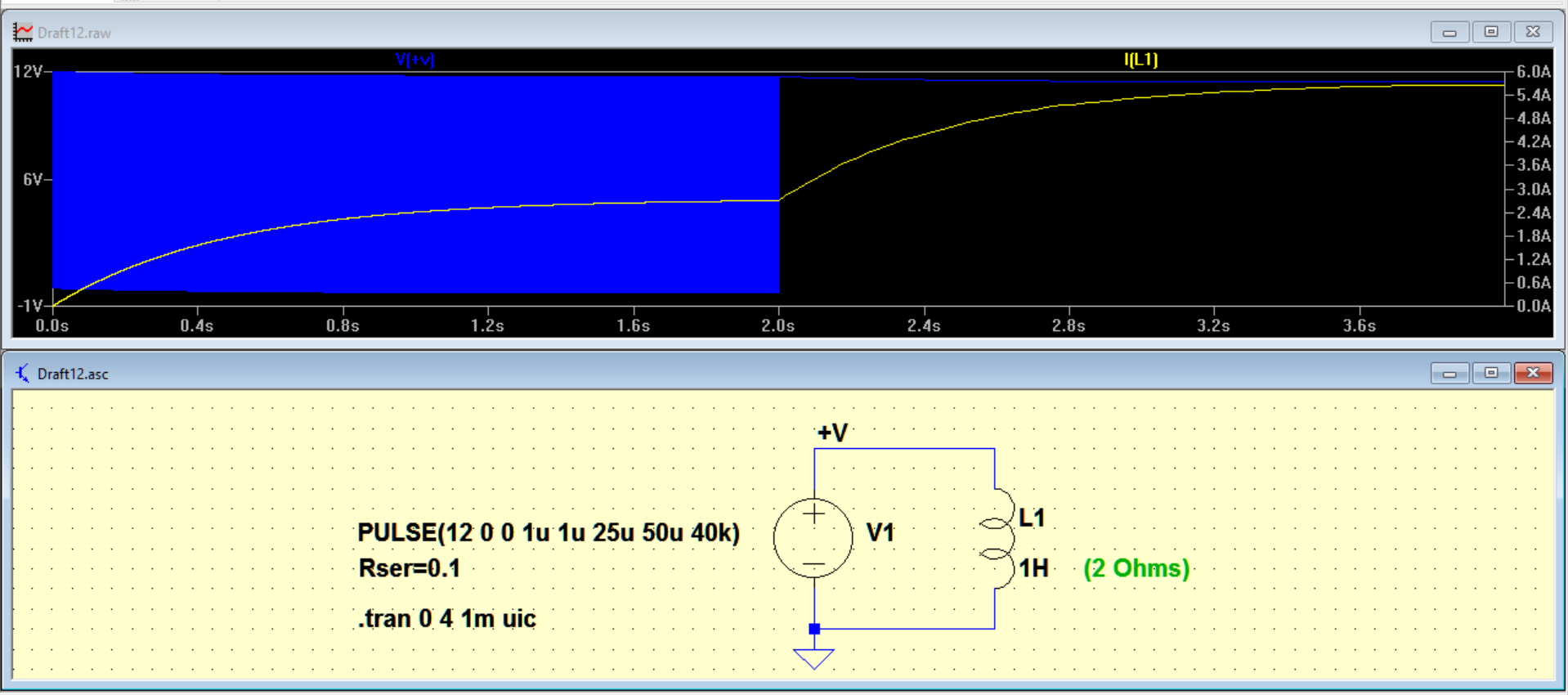

If the pwm is running at say 20kHz as an example & 99% duty cycle, we have a lot of Inductive Reactance & then we go to 100% duty cycle which is essentially a DC output with no pulse & no Inductive Reactance, what happens when the impedance drops to near zero?
This sim shows the effect, on a 1H 2Ω inductor, of switching a 12V supply from 20kHz 50% duty-cycle PWM to 100% duty-cycle.
Hi alec_t,
A simulation is worth a thousand words, I can't thank you enough for that, it says it all.
Thank you again!
Cheers
It is not a 2Ω inductor. It draws 75A at 12V, according to the post, which is about 0.16Ω.
Agreed, but the sim was just to demonstrate an effect on an arbitrary inductor, rather than a practical circuit.
Believe me compared to modern solid state power supply components these things have the electrical properties of steam engines not high end sports cars. :facepalm:
They may have gobs of power but they are slower than hell when it comes to changes in speed.
I'm sure that you're right about that. My experience has been with high frequency core materials.
But I think you agree that the current required for the free wheeling diode in this application, will probably exceed what a little 1 amp rectifier can be expected to provide.
But I think you agree that the current required for the free wheeling diode in this application, far exceeds what a little 1 amp rectifier can be expected to provide.
Yes and as I stated about using a power diode. I am not sure what constitutes a power diode in your terms but in mine it would be a stud mount or other such multi 10's of amps capacity type.
To be honest if a 1 - 2 ohm shunt resistor was placed in series with the free wheeling diode anything with a 20 amp rating would be more than sufficient given the equivalent series resistance of the coil plus resistor would limit the total peak amperage to well under 20% of the maximum running amps.

Thanks to John's explanation of various things to consider in the datasheets & chrisP58 commenting on the diode across the inductor has led me to read quite a lot about mosfets & inductive loads.
As I have read it appears that a free wheeling diode across an inductive load using mosfets is not a good idea.
The freewheeling diode & the body diode of the mosfet form a very low impedance path which can cause high current destroying the mosfet if any reversal from the supply exists at any time which apparently does happen.
An active clamp seems to be the way to go, also the free wheeling diode makes the rate of decay from the inductor slow due to creating a lower voltage scenario across it.
