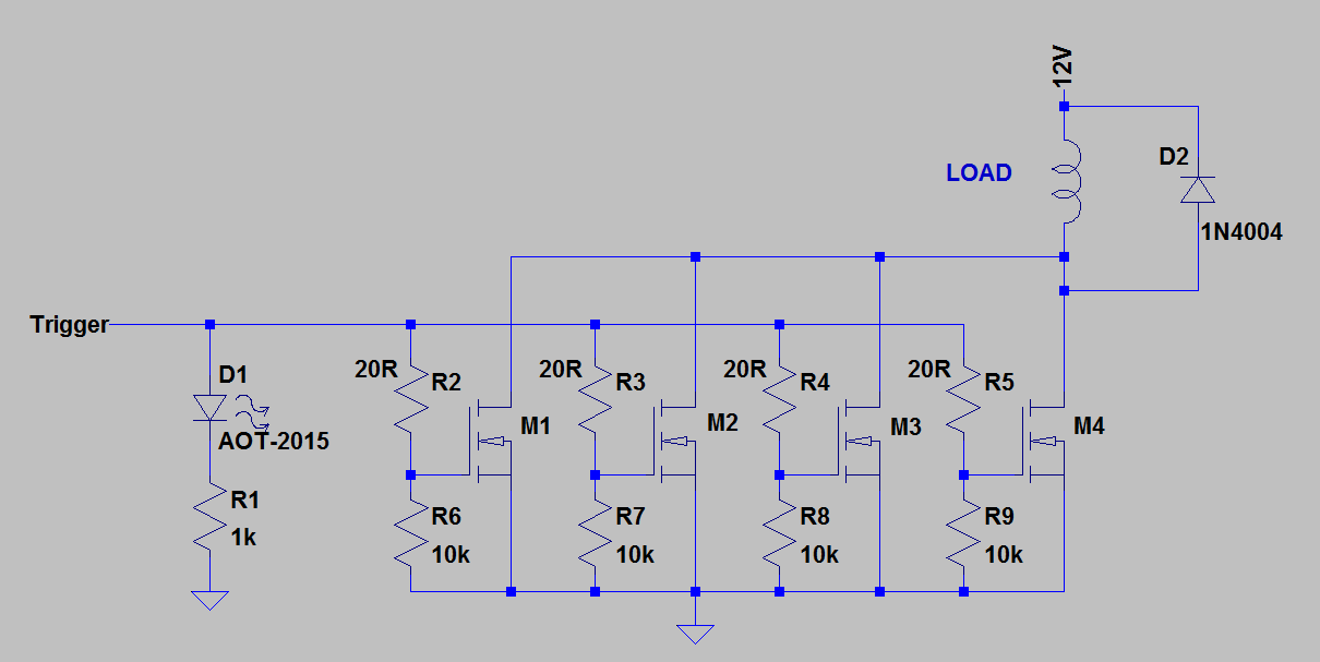

The gates are triggered all at the same time. You typically put a small resistor in series with each gate, just as you do with LED's, to balance the current and dampen oscillations ("ringing"). Those resistors are seen from the driver as being in parallel. Thus, 4 mosfets x20 Ω each will look to the driver as just 5 Ω. I built a couple of drivers for as large or larger inductive loads with similar and/or identical mosfets and used a dedicated IC for the gate driver and about 15 Ω per gate.

Of course, how quick is quick? For an electromagnet, you will probably be at 20kHz or less (of you can stand the noise). I was a little above that threshold. But still 20 kHz is not "quick" by some measures.
I used the LT1158 (http://cds.linear.com/docs/en/datasheet/1158fb.pdf) to drive up to 5 similar mosfets in parallel. That was more than 15 years ago, and the drives are still working. Be sure to include a gate turn off resistor. I once started in an unknown state and blew a mosfet. I suspect one could use separate drives, but I don't see the real need for doing that.

You most likely will have to reverse the DC at turn off, as is normal with scrap yard cranes, this avoids small pieces of scrap kept attracted by residual mag.
Yard cranes are typically full-on control, no PWM.
Max.

Forgot to add the attachment!
Is this circuit basically what I require, drive circuit not included or the H Bridge if required now.

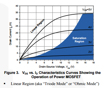

I have been trying to understand the Datasheet for the Mosfets & in particular the IRF 3205 which I wanted to use.
Could I get some help with this.
Datasheet attached.
I am a bit confused with this at the moment.
On page 4, Fig 8 is the Maximum Safe Operating Area graph, am I correct in saying that this Mosfet at 12V maximum will take about 7A only safely?
Am I reading this correctly?
Also, the Pd@Tc =25 °C is 200w obviously but above in the description of the Mosfet it says Power Dissipation of approx 50W.
This is due to the operating Temperature--Yes?
But then it says Id@Tc = 100°C the continuous Drain Current Vgs@ 10V is 80A
Could someone help me read this datasheet correctly so I know what I am looking at?

I agree that figure is a little confusing unless you realize what the variable plotted on the X-axis is. In other words, Vds is not the supply voltage per se, it is the observed voltage drop across the drain-source given various Rds(on) conditions (i.e, Vgs). The mosfet is being operated in the linear region as opposed to the saturated region (mostly horizontal lines). Vds is the current times the apparent resistance of the mosfet (Rds). This note from Fairchild describes what the SOA means in more detail than that datasheet does: https://www.fairchildsemi.com/application-notes/AN/AN-4161.pdf
I hope this figure helps understant the two modes of mosfet operation:
In the linear region, note that as current increases, the drain-source voltage increases virtually as if the mosfet were a passive resistor. For example, with just 2 V gate-source, the Rds resistance is high, so a small change in Ids causes a large change in Vds. NB: I am using the terms dependent and independent variable rather loosely and without regard to how the actual experiment is performed. The heat produced is I^2R and that is a controlling factor. The description in the Fairchild note is more complete. You will want to design your device for working in the linear region with a 10 Vgs so the device is fully turned on.
As for the turn-off resistors, I only used one for the 4 mosfets in parallel. Your driver may not even require that resistor. I agree with Max that you will most likely be working full on and full off most of the time. The need to reverse is interesting and makes sense.

As someone who has worked around the big 240+ VDC 50+ amp scrap yard crane electromagnets and controllers for years I have to say you are way over complicating what should be a simple process.
First off a small amount of variable resistance inline with the electromagnet like a large 500 watt 1- 2 ohm rheostat would give you a more than satisfactory power control over the unit.
For dropping you don't actually have to reverse the power polarity either. Simply opening the circuit and letting the electromagnets own field collapse through a free wheeling diode and a 1 - 1.5 ohm 50 watt resistor in parallel will give you a nice clean drop every time. ;)
All commercial mag controllers on such as fitted on Ohio Locomotive Crane rail crane products use reverse power for clean drop, they either use Hubbel or Square D magnet controllers.
Max.
Yes I am familiar with those designs and have made solid state units of my own design that have been in service for years without problems with dribbling and not needing to do the current reversing function to get a clean drop.
I know it works. It's simple electromagnetic field collapse physics. ;)
