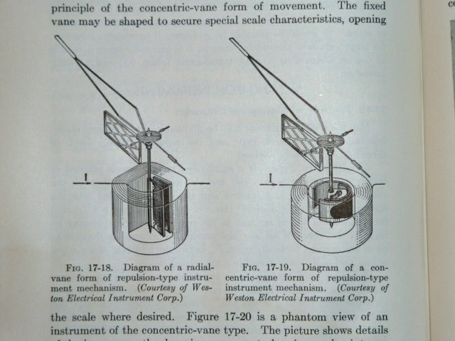

I have an old text that shows various meter types; it describes the moving iron movement and says that the torque is proportional to the square of the current. It also shows two styles of construction for moving iron movements; see the first attached image.

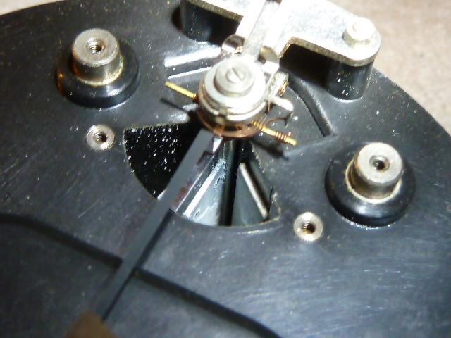

The second attached image shows the internal construction of the meter in the movie. The two vanes are clearly visible; this meter uses the radial vane type of construction.
There's a web page with some discussion of moving iron movements, mentioning that the torque is proportional to the square of the current:
https://electrical-engineering-portal.com/moving-iron-instruments-voltmeter-and-ammeter

Ok that's good, i forgot about the meter face that could be taking the square root, thanks for reminding me. This seems to work out then.
If we apply 7vdc we get 49 and the square root of that is 7 so we see 7 on the face.
If we apply 7vacpk we get 49 peak and the average of that is 24.5 (the average of sin^2 is 1/2 the peak) and taking the square root of that we get just a hair under 5 volts so we read 5 volts on the face.
Works out nicely, so that tells us that they really do calibrate the face to take the square root. Looking at the face, it is definitely non linear, and the distance in the vicinity of 10 is larger than the distance around 5 and it looks like it's roughly in the right proportion.
So i guess we proved not only is the moving vane meter taking the average of the square, the face is taking the square root so that works out to Vpeak/sqrt(2) as it should.
All is well in meterland :)
