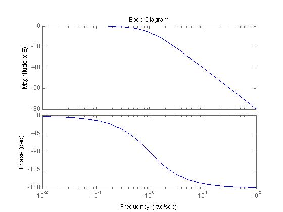

PG,
In principle the needle will move, but the amplitude of the motion is very tiny, and it is very fast. You can't see the movement, and it is a small amount.
Let's do an example. If damping is B=2, and spring constant is K=1, with mass M=1, you get the following transfer function. Note that I chose the parameters to give a critically damped second order system.
Differential Equation:
[latex]\frac{dx^2}{dt^2}=\frac{f}{M}-\frac{B}{M}\cdot\frac{dx}{dt}-\frac{K}{M}\cdotx=f-2\cdot\frac{dx}{dt}-x[/latex]
Take Laplace transform and find transfer function leads to:
[latex]\frac{X}{F}=\frac{1}{s^2+2s+1}[/latex]
Plug this into Matlab using the command sys=tf(1,[1 2 1]) and use the bode command to get the frequency response. You can do this yourself, but I attached the plot.
Now look at the response at high frequency and see how the response rolls off. This is a low-pass filter. If the magnitude response is 80 dB down from the DC response, this is 4 orders of magnitude. Hence if the needle moves 1 cm due to the DC part of the force (average value) then the sinusoidal variation in the needle movement might be less than 1 μm.
Now, can you see 1 um motion even if it's slow? Or, can you see 60 Hz variations in general?
Also, consider that other nonlinear effects, such as static friction, might even make this small motion impossible in reality.
