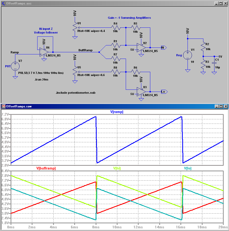

Talked to Mike and have redrawn the schematic **broken link removed** Now I have to rebuild it. Does anyone have a suggestion of how to couple the output of the PUT oscillator to OP1 and OP2 so I don't load it, This frees up OP4 so I can use it as a buffer for OP3.
Thank You Mike
Thanks all
Kinarfi
Here is a suggested circuit for the buffering of the PUT Ramp and the means of offsetting it high and low. Note that the offset ramps Hi and Lo get inverted, but I don't think that should matter.
