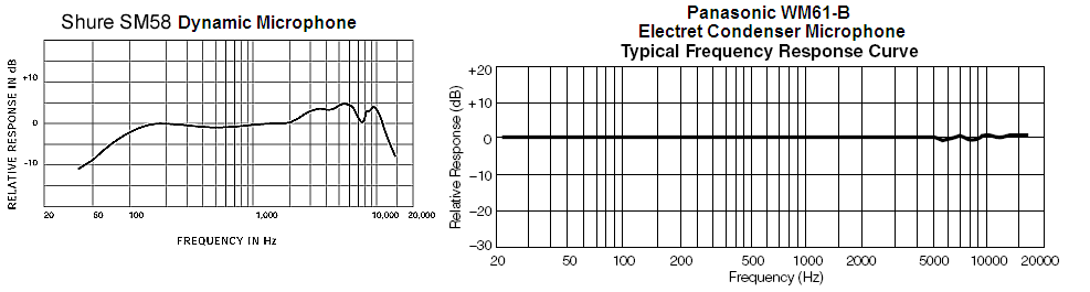

Most dynamic mics do not have a flat frequency response because they have resonances. Electret mics usually have a very flat frequency response.
The FET inside an electret mic that is powered from only 1.5V overloads easily.
Dynamic mics work well inside a very loud drum and when a singer is screaming.
