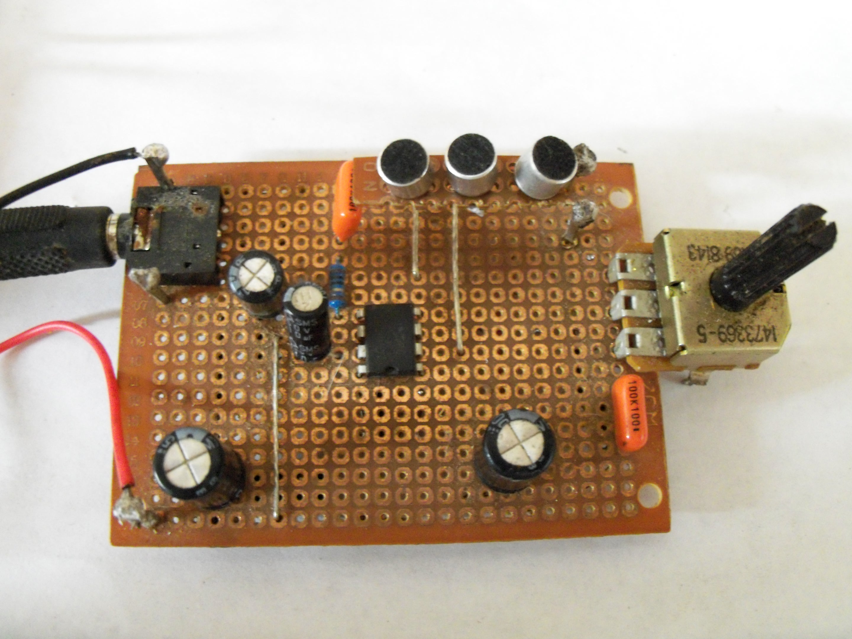

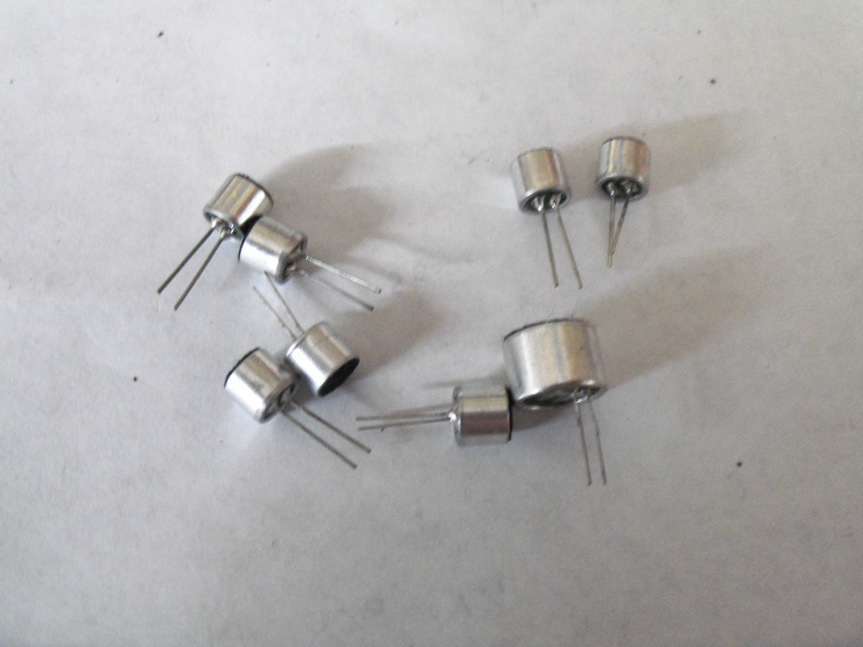

I accidently ordered 5mm mics not 10mm mics. 10mm mics are several times louder than 5mm. 5mm is not working on my project can I wire several 5s in parallel to work as good or better than 10mm?
Watch the phase! Can you tell pin1 from pin2?
Solder two together. Send a low frequency tone into the mics. Two mics, if wired right, will be better. Two mics if wired wrong will be much worse.

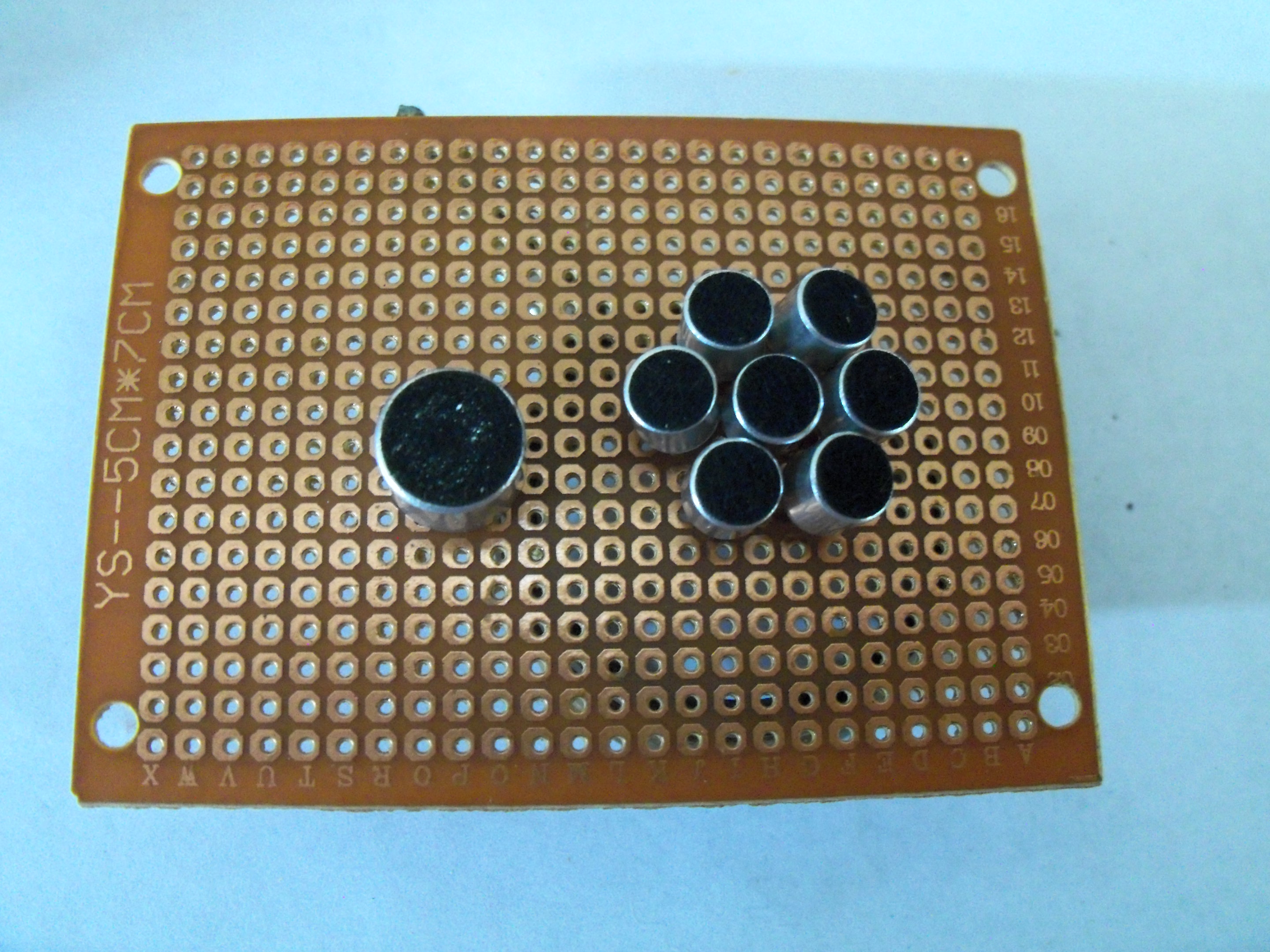

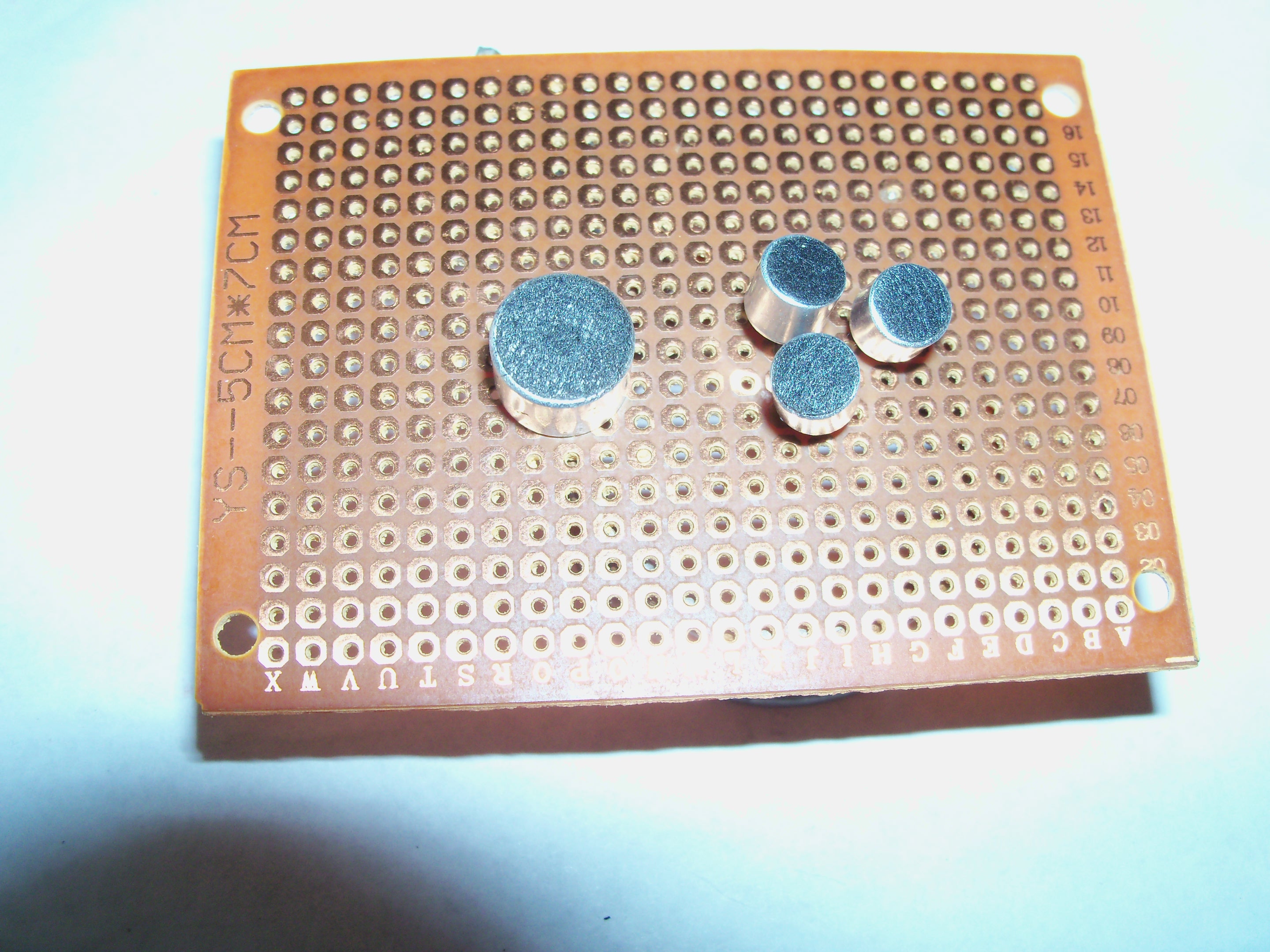

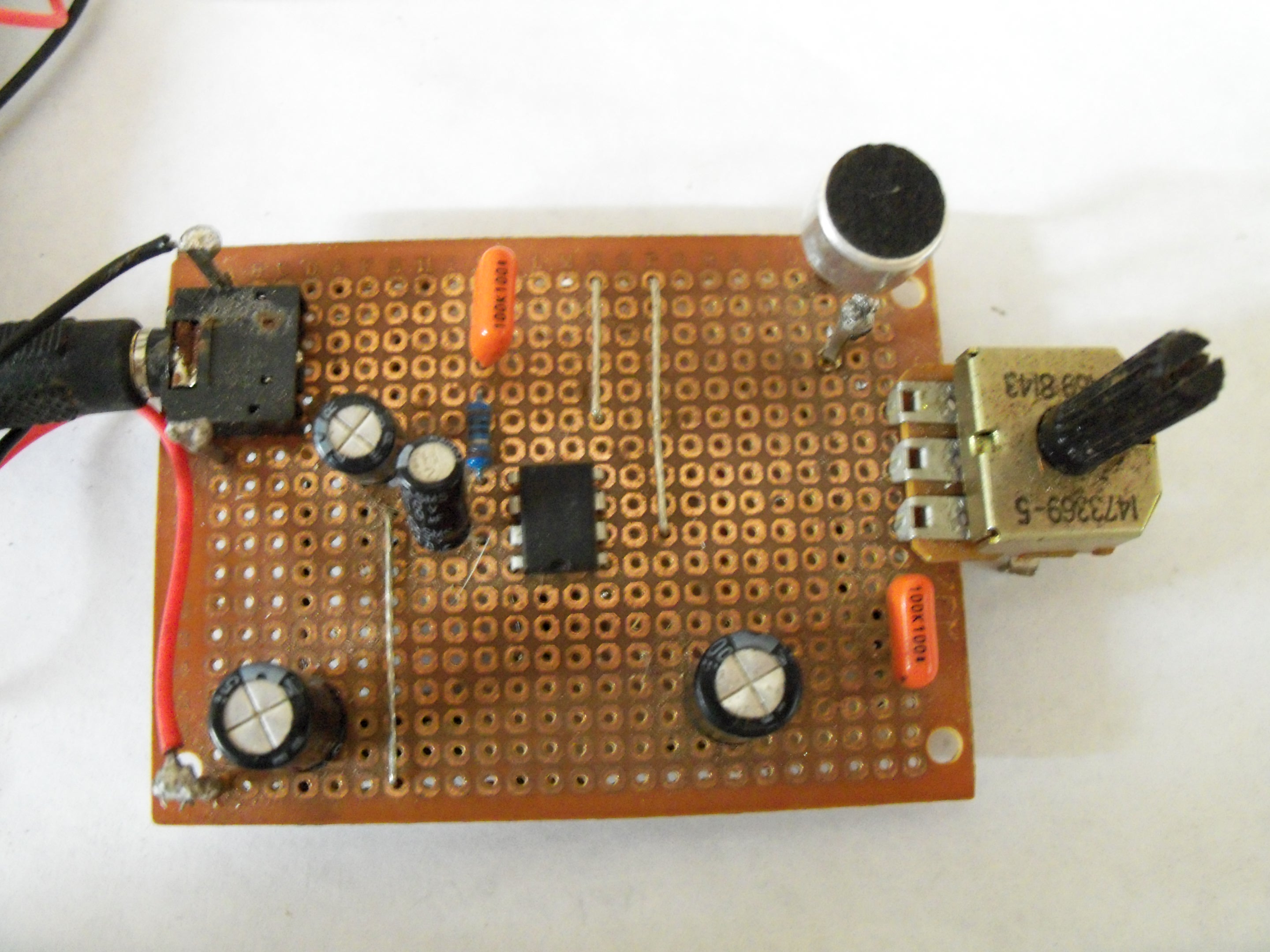

I know I tested a 5mm mic compared to a 10mm once it did not work well. I know I tested 2, 5mm mic in parallel to a 10mm it did not seem to works any better. Today I tested 3 of the 5mm mics in parallel to a 10mm mic it is noticeable louder than a single 5mm pic. Next I tested 8 of the 5mm mics in parallel to a 10mm pic it work fine in parallel. 8 of the 5mm mics are noticeable louder than 3 mics in parallel but still no where as loud as 1 single 10mm mic. Next thing to try 16 mics in parallel to see how loud it is compared to a single 10mm mic. As far as I am concerned 5mm mics are worthless compared to 10mm mics. I have a pack of 50 mics maybe I put all 50 of the 5mm mics in parallel on a PC board see how it works maybe it will finally = a 10mm mic. This will have to wait about 2 weeks too many other things to do at the moment.
I am running a 386 ic on 8AA batteries to some average quality stereo ear phones. Batteries all test 1.6v = 12.8v.

I made a mistake I have electret mic not ceramic. The 10mm mic has very good sound and many times louder than the 5mm mic. I should probably throw the 5mm mics in the trash they are a waste of time.
I got a 5mm electret mic from a cell phone and it works perfectly. Most of my other electret mics are 10mm and they also work perfectly.

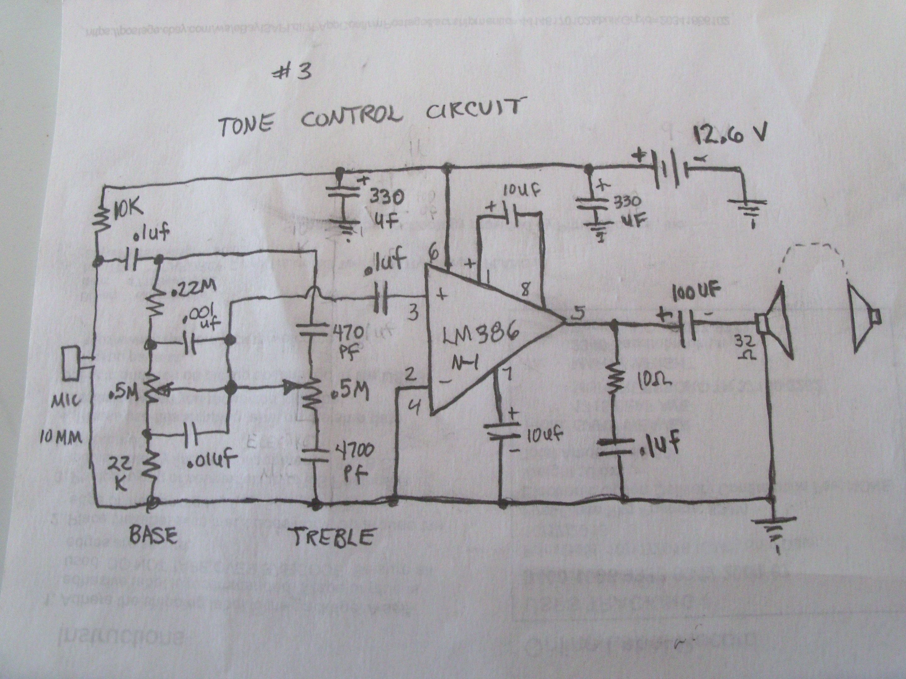

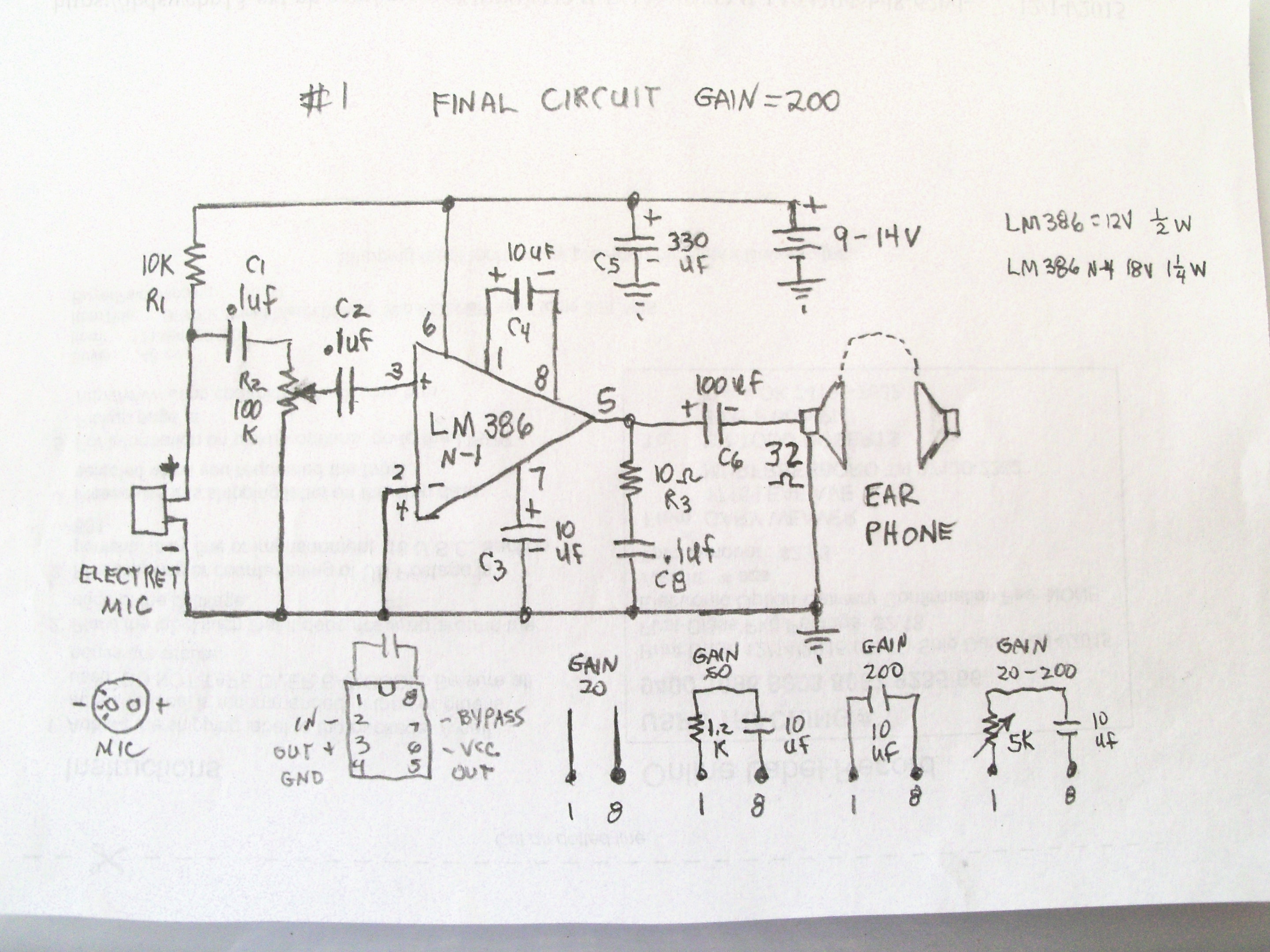

Here is the final circuit drawing. The PC board I experimented with is an older board it looks like all the parts were updated. I have several parts soldered on the bottom side of the PC board. IC part number is 386n-1. This old board needs to be stripped and start over it will be good for my tone control circuit.
Well I always think it's a horrible idea misusing a small power amplifier instead of using an opamp, and in this case even worse as adding passive tone controls means you make a large signal loss through the tone controls.
You do not need a capacitor in series with pin 3 on the LM386 because it already has a resistor to ground in it.
If you connect left and right 32 ohm earphones in parallel to make 16 ohms then the power from the LM386 will damage them and your hearing.
With a 12V supply, an LM386 output into 16 ohms is shown in its datasheet as 10Vp-p which is 0.78W RMS so each earphone gets 0.39W. But 0.1W is extremely loud and is damaging your hearing.
The 100uF capacitor value is too low since it cuts 100Hz and all lower frequencies.
Why do you have an amplified microphone and earphones?
There is only 1 ear phone.
Not speaking from experience, but I think that the array of microphones, when wired in parallel, will likely be a bit more directional than a single mic. That is because the signals will add more for sounds that reach each mic at the same time. Signals from off axis will reach each mic at different times, and will have a tendency to cancel each other instead of adding.
Of course, this effect will vary with frequency.

You are lucky that you have not be made deaf by the power amplifier.
