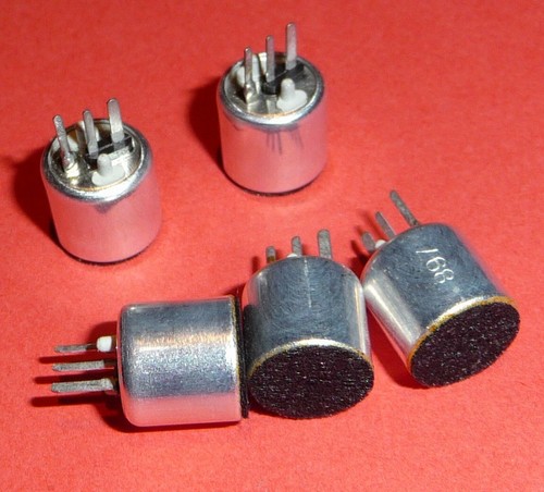

There are also three-terminal electret capsules, though not very common now. Those also bring out the source separately from the screen / electret element common which are the ground.
Edit - found an example:
The source in a two-wire capsule is also the ground connection; adding a resistor just increases the chance of noise pickup and reduces the output at the drain.

Another version, a three terminal with source as well as drain connections:
