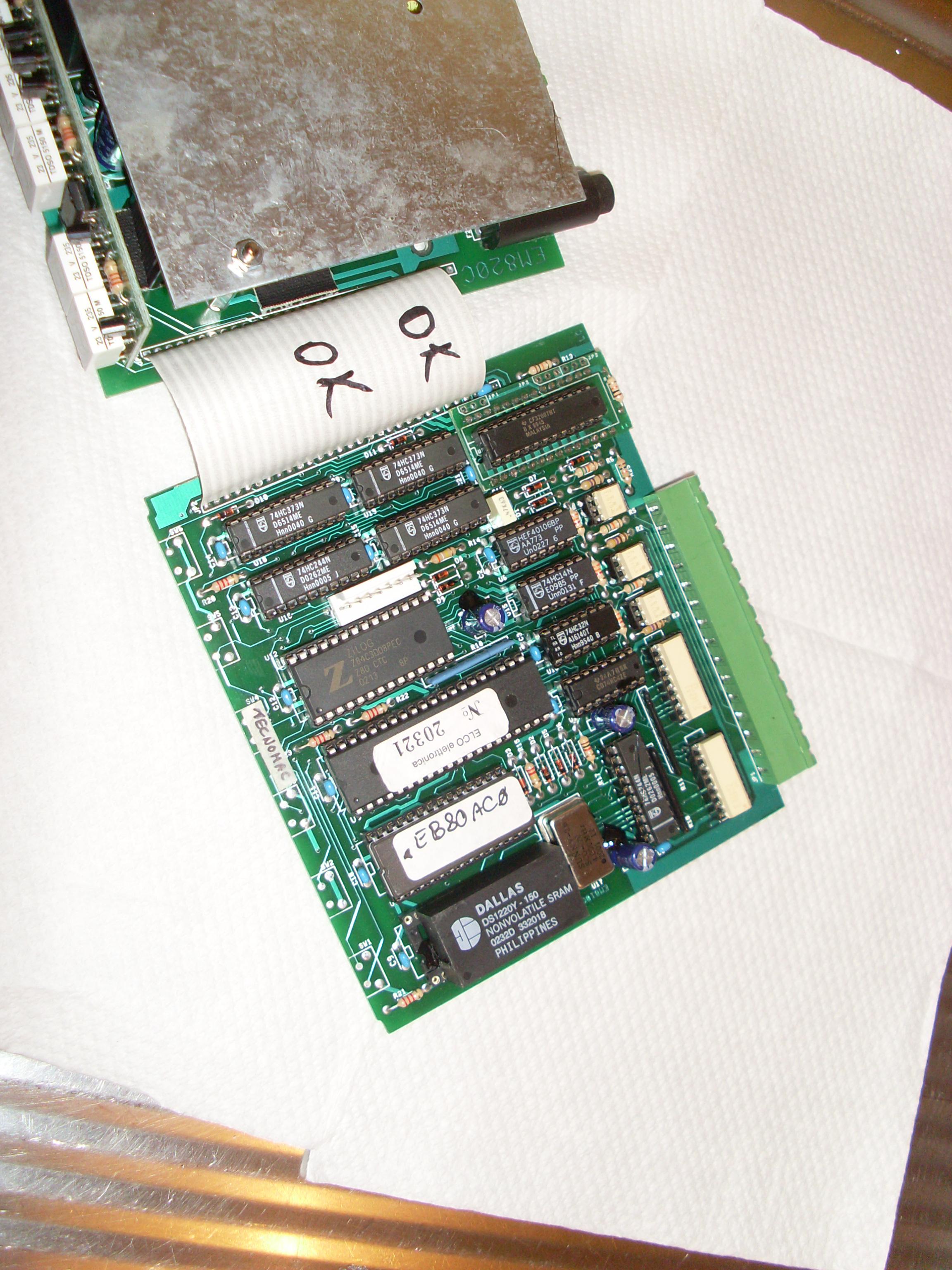

This ELCO controller is used on stone cutting equipment, made in Italy by ELCO ELETRONNICA. It has auto and manual programs.
When the machine is in manual mode, the LED display on the right, that is, under the P2, P3 and P4 blue signs, shows the distance travelled.
In manual mode, upon presssing the "0" button the display should clear up, reset. This particular button is used very often. Initially, it was thought the problem was the buttom, itself, from excessive usage.
The button has been tested and it works ok.
Also, some of the LED lights within the blue areas, like P1 and I believe P4 also not working.
I have traced the wire carrying the signal of the "0" button to the IC, abbreviated as 1, a 74HC373N, an octal D-type latch; 3-state. See image.
In addition, to looking for information on the 3 unknown ICs, see attachment, any suggestion why the display is not reseting. 74HC373N faulty ?????

it would appear that since the IDs have been rubbed off, the manufacturer doesnt want people to know what they were. if there are no markings at all your gonna have a tough time finding out what was used. Have you called the manufacturer and asked for a schematic??
This is an update on the initial information requested. The company purchased another such controller after the first one failed.
While the first unit has, now, been repaired. I was asked to repair the second unit, as well.
Somehow, the second unit escaped censorship and the attached photo shows the ICs present in such a controller.

If you have a board that has been repaired by someone else, take a real close look with a magnifier can you see which joints have been resoldered, check the date codes and the manufacturers symbols on the chips, is one different.
I've used this method a couple of times when I've sent boards out for repair, esp when they fail often, its sneaky but works.
