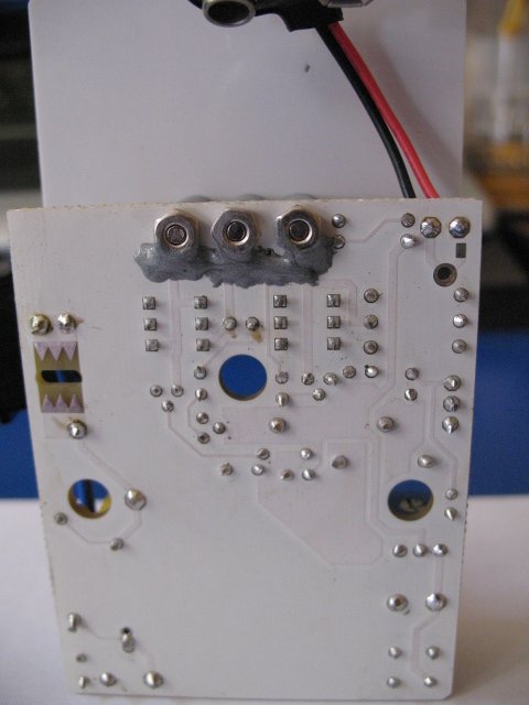

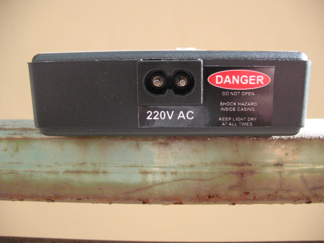

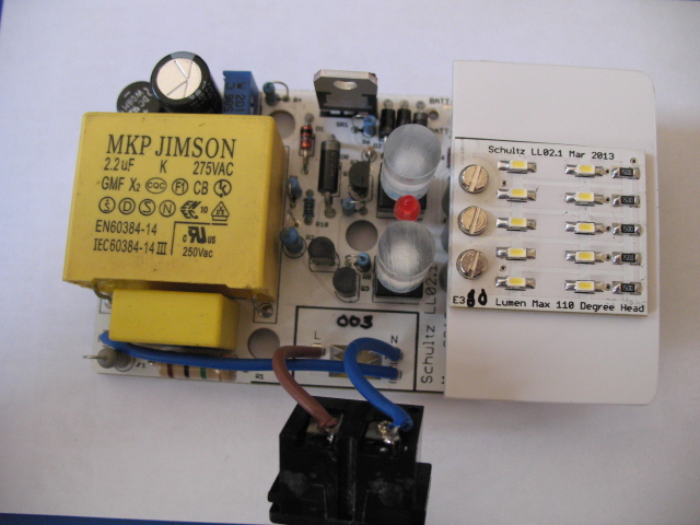

Here is how you work and deal with tranformerless supplies if you understand them:
Specifications:
125mA @ 10.15VDC continious output for ever @ 220VAC
can handle 3 phase input @ 380V AC for 5 mins when things go wrong from your electricity supplier
rugged as they come
tested non stop for 5 years, no sign of failure anywhere
gotta understand what youre doing
pics below:
