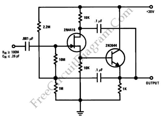

Probably going a bit over my head here, but I read a very long time ago a circuit description (in the Babini book "how to build your own solid state oscilloscope") where feedback to the scope's input transistor (a jfet) caused its gate to "appear" to have a very high impedance.
Sorry I don't have a schematic.
It's something that's always hung around in the back of my mind and never been properly processed - by what mechanism does feedback affect the input impedance?
(the 'scope worked really well, btw, though I no longer have it or the book)
It depends upon the type of feedback. If it consists of negative feedback from a resistor to the input, then it would reduce the input impedance. If it consists of a resistor in series with the source lead, then it would tend to increase the input impedance.
This is from National application notes.
If the bottom .1uf cap was removed. The input impedance is (10M + 2.2M//1M).
With the .1uf cap; the same signal fed into the amplifier is also fed into the point where these three resistor meat. That way both ends of the 10M resistor see the same signal. With no voltage drop across the 10M resistor the input impedance is very high.
Is this what you are looking for?

You're perhaps confusing yourself by using the term 'feedback'?, it's more correctly (and less generically) called 'bootstrapping' - and one of it's major uses is to increase input impedance.
Note that bootstrapping increases impedance (for AC signals). It does not increase the DC resistance.
The signal seen at the emitter of the 2N3644, vis-a-vis the input signal, isn't it somewhat out of phase? If so, how does it plays into this?
My only concern if the capacitor from the drain of the FET? - what's that there for?.
The source and emitter followers will keep the phase identical for the bootstrapping, but connecting the drain to the output seems bizarre?.
Not really. It's another bootstrap which results in the drain voltage swing being in phase with the gate input, so effectively reduces the drain-gate capacitance.
Oh I see - and it works because the FET is a source follower.

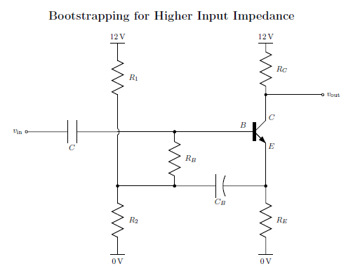

So, is the same technique relevant for a bipolar input transistor?
work with....transistor?
yes...... but the JFET uses 1/10 the current to start out with.
1/10 is a phrase meaning "less than" and not to be taken literately.
Yes, it works for a bjt too.

Posts 3 and 8 show the circuit of a high input impedance amplifier.
The actual text from the application note AN-32 of february 1970 says;
"Nothing is left to chance in reducing input capacitance. The 2N 4416 , which has low capacitance in the first place, is operated as a source follower with bootstrapped gate bias resistor and drain. Any input capacitance you get with this circuit is due to poor layout techniques".
Zin>100 megohm
Cin < 25 pF.
Note the gain is 1 at the source AND the drain due to the two 10k resistors. BOTH the drain AND the gate bias resistor is bootstrapped. The leading current into the drain, applies a bootstrapping current to reduce the effect of the gate to drain capacitance.
