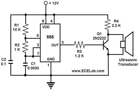

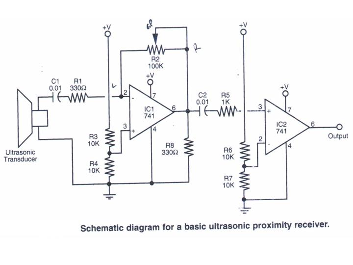

i have a transmitter circuit with 555 timer and receiver with 741 op-amp and need to verify it.. give your suggestion... please...

That circuit won't work for a couple of reasons:
1) The 741 won't work at audible frequencies, let alone ultrasonic.
2) it doesn't measure the timing of the return signal, just the intensity, so you'll get a different result, if the object is made of something absorbent than if it's made of a reflective material.
