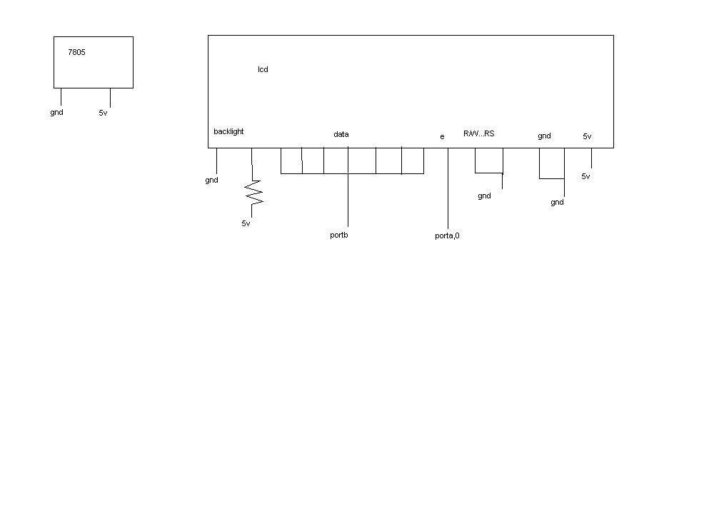

A pic 16f628a. Read/Write and RegisterSelection pins are to ground (for write and instruction mode)
E pin is on porta,0 and the portb is on the data bus lines(in the right order).
Just to blink the cursor...but it does'nt.
Very strange... I have took an program from another forum member that had the same problems then me and fixed them, loaded it after minor mods and ... does'nt works! he use an lcm1602a, the almost same then ecm1602a.

I think that my pic has gone crazy or something because the pin 7 and 6 of the PORTB goes high several times before being high for ever because of the loop at the en of the program... I Tested that by putting an led on the mcu port................................................................................................
As you can see, in all the movlw b'xxxxxxxx' the msb and bit 6 are HIGH ONLY at the end of the program, but my led lights up 8 times...
The PORTB is not acting the way it supposed at all!And its not the first time
Can someone explain that?
(Could it be the pickit2 or the pic?)
I REALLY REALLY REALLY need your help.
