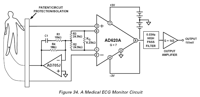

Hello,,
i wanna make ECG 3 chanel for my modul,,
need referensi about it
You have only one heart so why do you need 3 channels?
The datasheet for an instrumentation amplifier IC (AD620A or many others) shows the circuit.
Hospital cardio units use a 12 Lead system which uses 6 probes placed in exact locations... with this system, they can tell if your heart is in vfib or afib (and another I can't think of immediately)... different rythyms from different types of heart attacks (mycardio infarction), and very different recovery/treatment techniques. I used to help train my wife when she did her Advanced Life Support requalifications.
