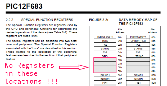

Hello, it will become apparent very quickly that I am a beginner at this whole pic programming thing. I have read the newcomer section and looked at a lot of the weblinks but am still struggling with a delay problem.
I am using the PicKit2 and can get the LED to go off and on using the switch but cannot get it to flash when I try the simple delay program that I plagerised from the internet.
Loop1 decfsz COUNT1,1
goto Loop1
decfsz COUNT2,1
goto Loop1
I have assigned the COUNT1 equ 08h and COUNT2 equ 09h.
When I run the debugger in mplab and step through the program it never comes out of the first decfsz COUNT1,1 instruction. It just continues to go round.
This is then emulated by the LED when I download the program onto the PIC in that it simply stays on all the time. I have spent a few nights on this trying various things and am really in need of some help.
As I am a complete newcomer to PICs and programming I am unsure if there is anything else I need to set up before starting the decrement instruction.
Do I need to assign a value to the 08h and 09h addresses before the decrement instruction starts?

This would answer your question.
yes that would appear to explain it!! I was under the impression that they were writable as it said unimplemented. Thanks for that.

OK I changed the code to read Count1 equ 20h and Count2 equ 21h but it still doesn't work. Is the comparator a red herring or do I need to sort it out first?
I take it that I really need to set up the CMCON0 register as described in page 33 of the data sheet? Otherwise I will encounter problems?
The other area I noticed was that to switch the comparator off Bits 2 - 0 in CMCON0 should be '111' as described on page 49. CM<2:0>=111.
I suppose that would make sense as the
MOVLW 07h
MOVWF CMCON0
would do that for you!?

If you check my PIC tutorials, most of them use the 16F628 - this needs the comparators disabling as well, so you can see how it's done.
Also, don't write code like this
decfsz COUNT2, 1
Use the MicroChip provided equates, it should read
decfsz COUNT2, F
So it writes back to the GPR and not W (I've no idea which '1' does, because it's not something I would ever do). By using the provided 'names' it makes the code more readable, and there's less chance of errors.

Personally I've never used the simulator, and never felt the need - there was a DOS based one, and that was truely horrible!.
I take it MPASMWIN would tell you if your code did not build before you downloaded it to the PIC.
Yes, it gives you error messages, and won't create the .HEX file if it fails. Any errors are written to a .ERR file.
