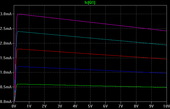

There was a thread about 2 years ago that dealt with the Early effect. In it, I posted a spoof graph illustrating the Late effect (see attachment). Definitely engineering humor, possibly only funny to yours truly.:rolleyes:
Actually, it was quite witty. Thanks for posting it and the link. Probably not Leno or Letterman material but we can't all be engineers, right? LOL

The late effect has negative resistance so it will make a good oscillator.

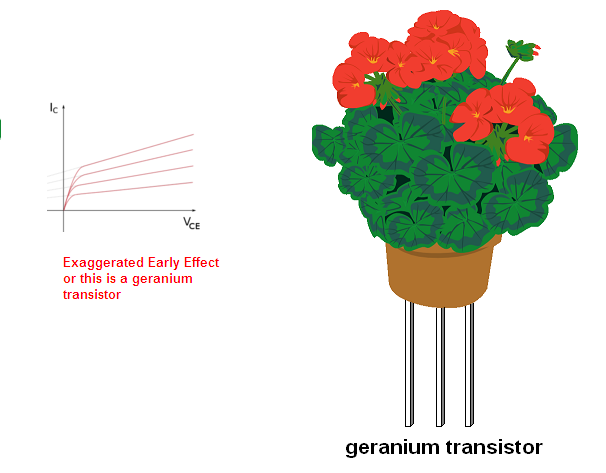

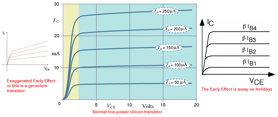

I also have a spoof of the Early effect:
You posted the VI curves of a geranium transistor. I happen to have a rare sample of one. It still works, and probably will as long as I remember to keep it watered.
Attached is a picture, along with the VI curves you posted.

The "geranium" spelling error was part of the spoof.
I also spelled "silicon" wrong but I corrected it.
You can add the silicone transistor (from Silicone Valley) to the mix.

BTW, I created that Late effect plot with an LTspice simulation.:p
