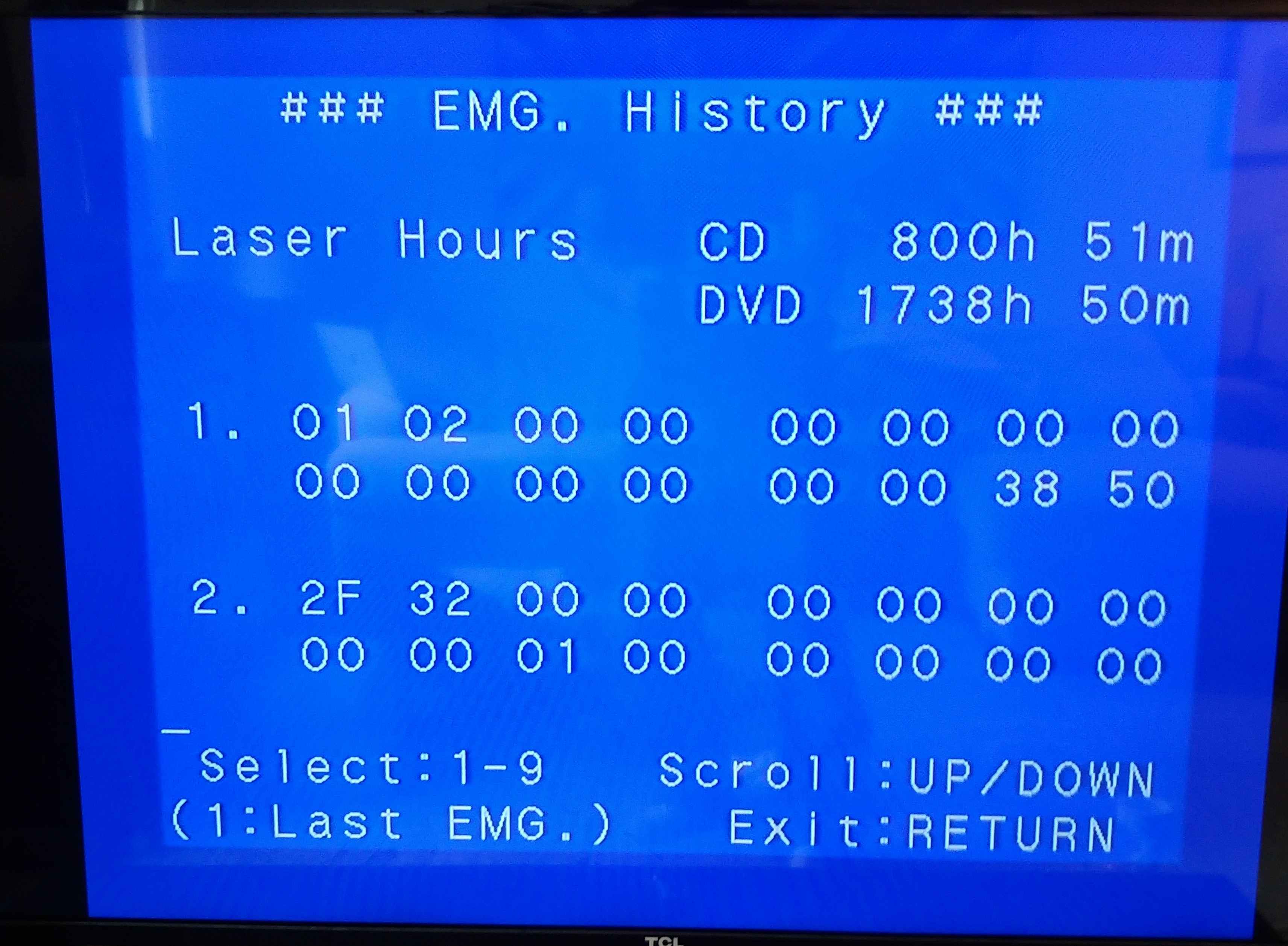

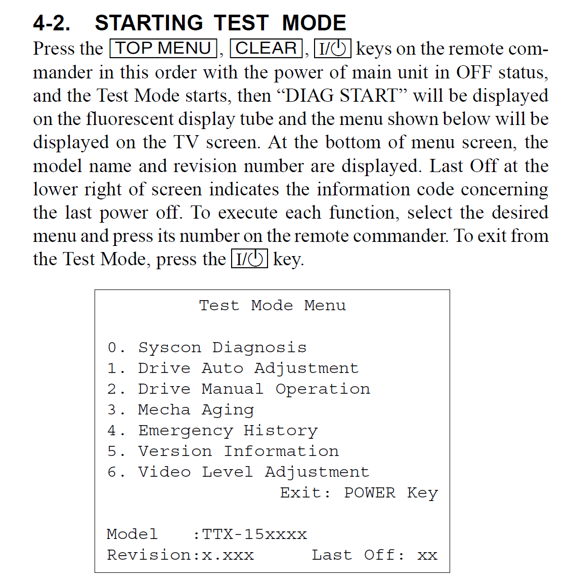

Selecting number 1 or 2 on menu just leads me to a blank blue screen. I am able to select 0. Syscon Diagnosis and run through the test all function.

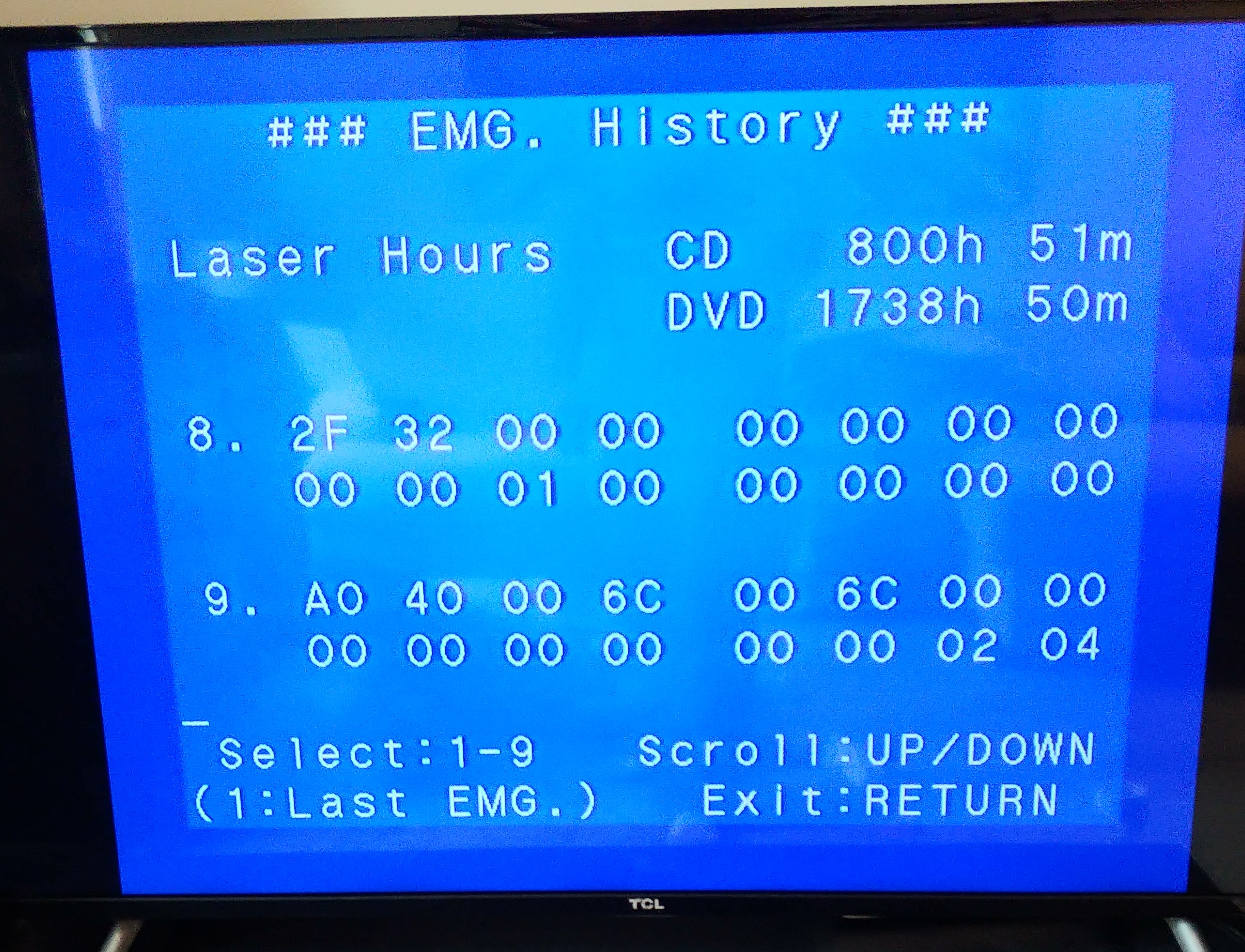

I can select 4. Emergency History and it gives me several error codes but I can't seem to find what they mean at all. I have searched across the internet.
I fixed one of these DVD changers with the same or a similar problem. There are two loading switches (in & out), and a table locking switch. If the table locking switch does not close at the end of the disc loading, the motor will stay on. You can easily test this by pulling to ground the pin of the connector on the mainboard corresponding to this switch when you see the table lock occurring. If that stops the motion then you know the fix. There are 4 pins on an 8-pin connector coming from the loading/lock switches. LoadIn, LoadOut, TableLock and GND. The switches are active low (i.e. they pull pin to GND when closed). You can also check continuity on these 3 to GND as you manually move the loading mechanism using the pulley. The connector pins are marked on the mainboard.
