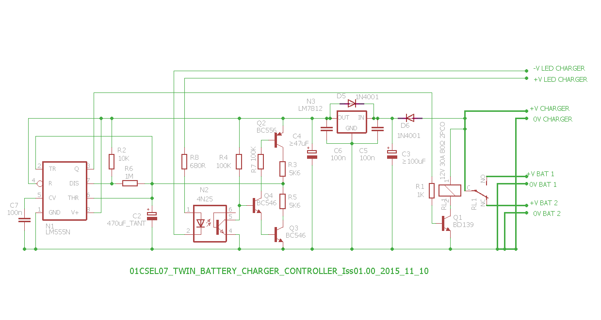

I have a circuit in mind but need to work out a few details. As I see it, a good way to impliment the function is to do the switching with a standard 1 pole change-over, 10A, 12V auto relay. The control should be fairly straignt forward using an LM555 timer chip.
Re (5) above, how would it be if once battery 1 were fully charged, the battery charger switched over to battery 2 after say 5 minutes, and then charged battery 2. 5 minutes after battery 2 is charged, howevever long that took, and the charger LED illuminates again, if the charger were to switch back to battery 1 again. If battery 1 were still fully charged 5 minutes later the charger would switch back to battery 2 and so on. If battery 1 were discharged, it would charge that, once again, no matter how long it took. I only ask because it may make the design simpler. It does have the advantage that you could leave it running and both batteries would be kept topped up, but this depends on the type of charger you have. Most auto batteries shouldn't be too bothered about 4.2A (4,200mA). You could specify any time you like; I just used 5 minutes as a suitable example. I think this operation would suit you from what you say.

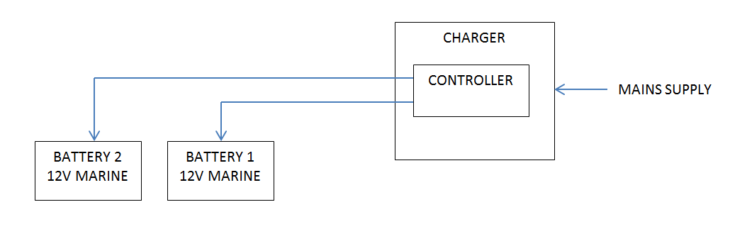

In terms of the physical implementation there seem to be two broad approaches.
(Approach 1) Don't modify the charger at all; just tape an opto sensor to the charger front panel so it sees the battery charger LED and have the rest of the electronics in a separate waterproof box.
(Approach 2) This would be the neatest and most user friendly, but we would need to know the circuit of the LED. I suspect this could be fairly easily derived by simply looking inside the battery charger.
If there is room it would be best to have the controller inside the battery charger with two wires exiting for the two batteries. This would seem to be the best approach especially for a marine environment, and in view of the fact that you dont mind 'tinkering'.
Finally whichever approach you decide on I would recommend a 10A fuse in each of the battry cords unless the battery charger already has over current protection.
