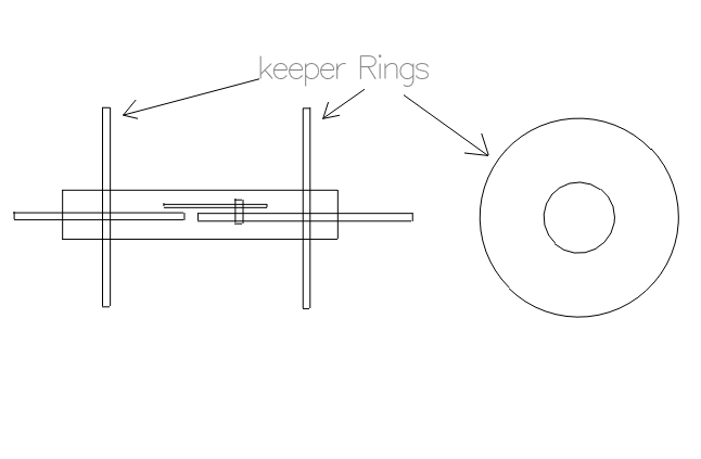

all ya gotta do is drill a hole in (something round & flat ).
apply hot glue to the outside (around yer reed switch.)
and wind the inside with 30 gage wire (or smaller) .
Willi, you need to read the question a little more carefully.

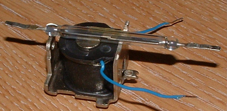

Remove the coil from a large relay, place the reed switch across the magnetic circuit of the relay coil.
You could use a thin copper foil between the relay and the switch to minimise capacitive coupling.

Jim, I think what you describe works just fine for switching. Unfortunately, I'm not in a position to have relay disassembly an option for volume manufacturing. Thanks!
