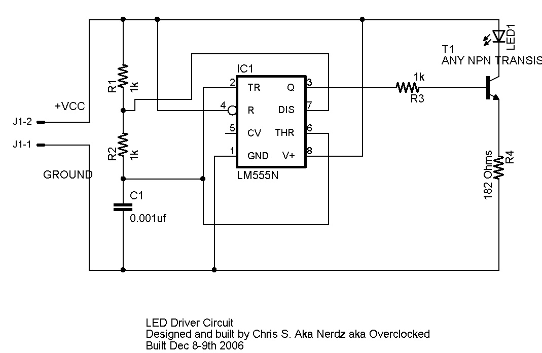

Can you post the schematic of you circuit?

Can Do. I didnt show the different emitter resistors with the switch.

Your 555 circuit makes a 67% on, 33% off duty-cylcle. So the LEDs are dimmed 33%. Why? Your switched resistors should do the dimming.
So If I understand Correctly, I should have eliminated the emitter resistor all together? Or are you saying I should Eliminate the 555 Timer all together and Just use the transistor?
If you eliminate the current-limiting resistor then the LEDs and transistor blow up.
The 555 and the transistor are doing nothing but dimming. An ordinary resistor can do dimming just as well all by itself.

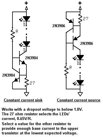

A two-transistors current regulator is good enough to mintain the brightness of LEDs as the battery voltage runs down.
But what about efficiency?

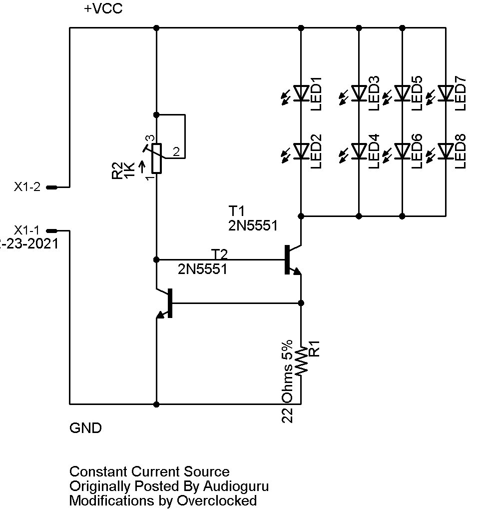

I Just Built that Circuit and experimented for a half hour. Looks like My battery is Dieing, I measured it to be around 6.67V. This maybe a good thing, since it would give me an Idea of How the circuit would perform when the battery is near its death.
Interestingly enough, I used 8 Blue LEDs (Each is Rated at 3.6V 20mA) And Got around 22mA Draw Total. Each LED Got 3V. I used Blue since I dont have any White LEDs LEDs left.
Heres what I used for values:
Why did you use 4 strings of LEDs? With a total of only 22mA then each string draws only 22/4= 5.5mA. One string of two LEDs in series would produce the same amount of light at 22mA and the battery would last as long.
Why is the value of the pot only 1k? It is wasting power. The current gain of the transistor is typically 150 so if the battery voltage drops to 7V and the LED current is 22mA then the value of the pot is (7V-6V)/(22ma/150)= 6.8k. Use a 10k pot.

To maximize brightness.(or atleast I thought it did...Maybe all it did was increase the angle?)
I used 1K for experimentation, I do know 6.8k is a standard value, but I'll use 10k for experimentation.
Your transistors have a very wide range of current gain and you don't know the amount for the transistors you have, so you need the trimpot to adjust for the amount of output current.

I Fully Optimized the circuit today. I used a 12V source but I used a pot to adjust the voltage to appr 8.99V.
I used 2 LEDs in series. The total current being consumed is 21.20mA, and Each LEDs Gets 3V. I also noticed that when I adjusted the voltage That the LEDs remain at the same brightness no matter what the Input voltage (but this is to be expected of a constant current source). The LEDs start to get dim below 6.65V.
What would happen if I changed the Transistor to say, a darlington transistor?
