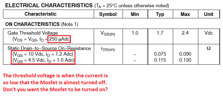

    It is a switch. A mechanical switch has a resistance of zero ohms. If the Mosfet has a Rds of 1 ohm and you switch 1A through it then it will cause a voltage loss of 1A x 1 ohm= 1Volt which will cause the motor to run slow and will cause heat in the Mosfet. You want a very low Rds.
    The Vgs is 1.7V.
    Absolutely not! Look at the datasheet. The threshold typical voltage is 1.7V but is 2.4V for some of them. The current at the threshold voltage is only 250uA (0.25mA) so it is barely turned on and is almost turned off. Don't you want it to be turned on well?
    I am using 3V to drive the gate.
    The tiny Mosfet's datasheet shows that it is turned on well when its Vgs is 10V and is turned on not bad but not good with a Vgs of 4.5V.
    The graphs on a datasheet are for a typical device that you cannot buy, you get whatever they have unless you buy thousands, test them all and maybe find some sensitive ones.

The threshold voltage of a Mosfet is when it has a very low current and is almost turned off. Its "On Resistance" shows the Vgs it needs to be turned on.
The graphs on a datasheet are for a "typical" one that you cannot buy. Some are minimum and some are maximum. If only Mosfets with a threshold voltage at the maximum of 2.4V are available then their current will be fairly low with a Vgs of 3V.
