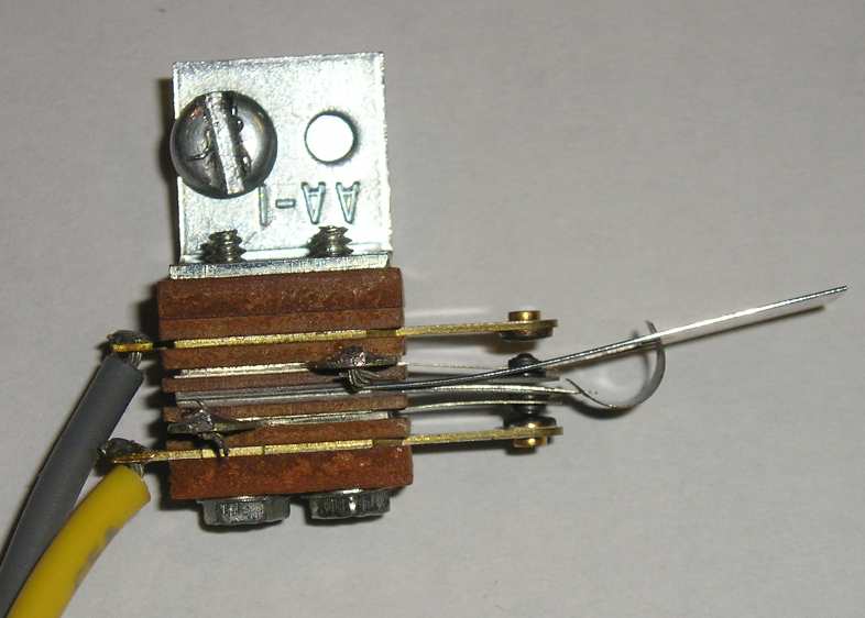

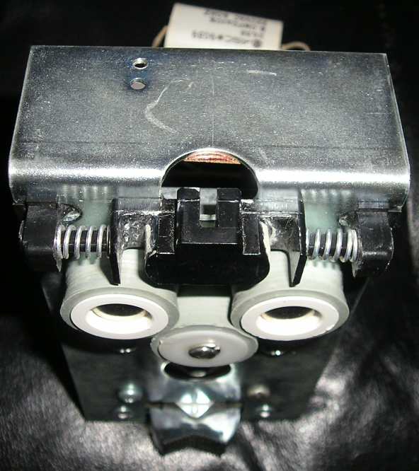

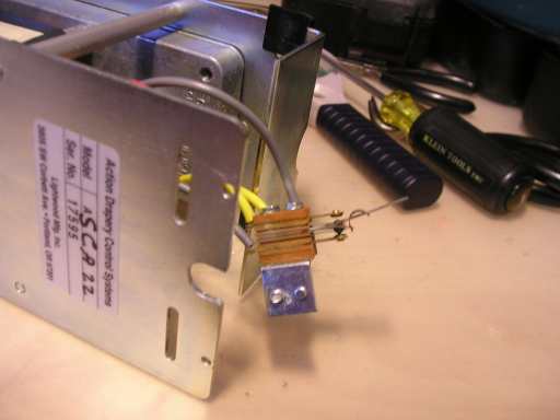

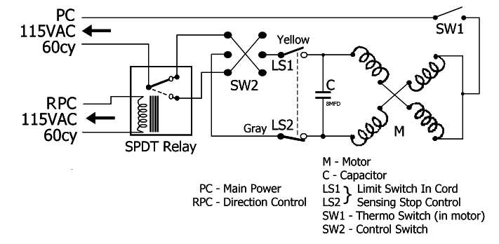

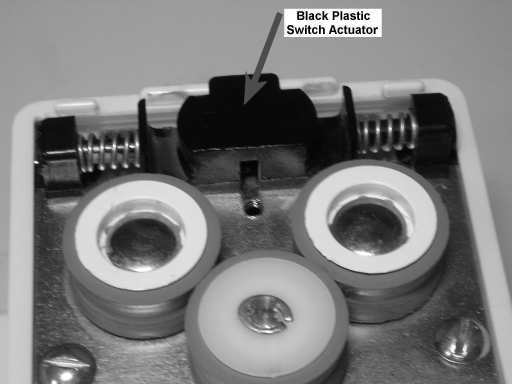

Here is a couple pics of the motor and the schematic. You can see the black plastic actuator that is pushed sideways by the force of the draw cord and the spring loaded snap type limit switch which is where the problem lies.

Close-ups of click-type limit switch and the actuator.

What kills me is the switch and all look fine and the contacts are good. I might be the curved spring that can be seen on the limit swiitch because the switch works well in one direction but does't flip/click to the other direction with the same amount of force. I can't seem to duplicate this when it is apart.
