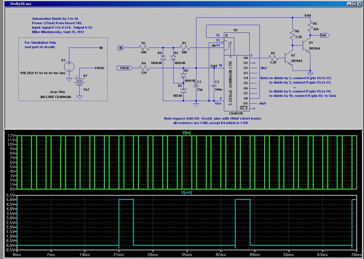

I have a digital wheel speed sensor that reads the speed of a turbine wheel on a turbo. It is set at factory to a peak of 4,666 events per second 4.6KHz (from 0-4666)
I need it to peak at 500 events per second. 500 Hz to be able to read it on the afermarket computer. The software in the computer can only read up to 500hz.
Reduce by 9.333 ~ 10? So what would I need to take this output and get it divided by 10 so it can read effectively through the computer software that runs the car. It is a PWM signal I am sure. I think it is a 12v-13.2v peak to peak. Although it might be a 5v peak to peak. I do not think this will be an issue as amplitude. It is the time frame that needs reducing to be readable.

This should do what you need. I designed it so you do not have to know what the amplitude of the input pulse train is. I also made it such that it should be relatively bullet-proof vis-a-vis the transients in the car's electrical system. The input signal is clamped such that a spike on the input shouldn't do anything, either. The output is set up for 0 to 5V; but it could be changed for 0 to 12V....
The simulation shows an input signal of 12V being clamped at 5V at the input of the counter. Write back if there is something you don't understand...

Awesome! If I knew more on how to use LT Splice simulation, I'd give it try. I will bread-board it and check it out on the scope. I know the power supply will be off Ign. somewhere. The output amplitude of the optical sensor is 5v. The PC reads it as a 5v input peaking at 500hz. So we will see how it down converts.

Do pins 13, 15 need tobe "open" (no connections). Also, it is Pin O0 that is the x10 pinout? (I thought it was pin 9) I am sure it is based on your simulator.
Actually, if the modulus of the counter is set up to divide by 10 (i.e. the counter is not short-cycled by hooking up some feedback to pins 13 and 15, any of the outputs will at 1/10 the clock frequency, so you can use any of them you like... :) Pins 13 and 15 must be tied to ground (Vss).

No, the 4017 doesn't use RC timing. It's a Johnson Counter and will divide by any number between 2 and 10. As drawn in the circuit above, it's a divide by 10. To make it divide by a lesser factor, connect the RESET pin (pin 15) to the appropriate output; e.g. connecting O5 to R will create a divide by 5 counter. Using O3 creates a divide by 3, O7 a divide by 7 and so on.

So it "appears" as if Pin 15 is "floating"? Am I correct? It is set up now with no connection to Pin 15. Is Pin O0 the 10x pin then? I read the schematic as both 13 and 15 as unconnected to anything.

I'm referring to the schematic MikeMI posted. You'll notice that pin 15 (reset) is connected to ground. That allows /10. Connect pin 15 to the appropriate output to get a different divisor. O2...O9 allow for divide by 2...9 respectively. Only connect pin 15 to a single output or to ground. Don't connect it to O0 or O1, as they won't give you a useful output.
