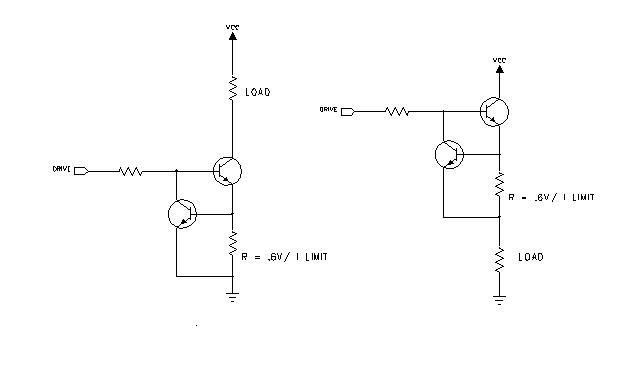

And.... a fully turned on transistor has a VBE of .7v, but the knee starts at .6v, that's why in the previous message 5 ohm yielded .12A. I always use .6v when I calculate current limiting resistors. Here is a circuit I use, the one on the left. I adapted it from the data sheet of, YES, the 7805. Look at the output stage of the 7805 and compare that to the circuit on the right.
