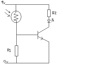

I've created a simple light activated switch as per the attached drawing. It works great but now i'm getting a little more adventurous! I now want to use two LDRs so that when either of them senses light the single LED will come on.
any help anyone can give to point me in the right direction would be much appreciated.
Thanks! :)

You could put another LDR in parallel with the existing LDR, you may have to adjust the resistor value from the transistor base to 0V.
Another way would be to make an identical circuit [without the LED and resistor] and connect the two transistor collectors together.
Does this help?
Thanks ericgibbs !!
I've tried adding it in parallel and that seems to work. I will try your other suggestion as well later and see how it goes as well.
thanks again.

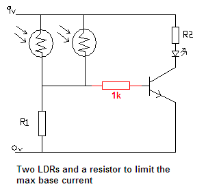

If both LDRs in parallel have a bright light then the base current in the transistor might be too high. Limit the base current with a resistor like this:

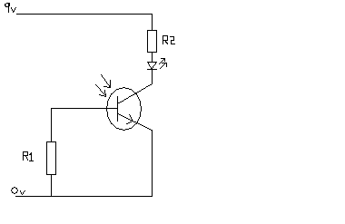

Eric, i had actually saved that doc onto my computer after having found it earlier. It did help a bit but i'm still not 100% sure exactly how to do it. I have attached a simple diagram of how i figure it might be setup for one light source input (didn't want to complicate things even further at this stage with two inputs!)
My understanding is that when light shines onto the phototransistor it will allow a current to pass through the Collector / Emitter junctions and light up the LED. the resistor R1 can be adjusted to change the amount of light required to switch the phototransistor on. is this right?

A photo-transistor needs to have a very bright light on it for it to pass the high current of an LED.
Replace the LDR in your original circuit (it has a regular transistor as an amplifier) with a photo-transistor then it will be more sensitive.
I agree with agu.
IMO you do not need the base resistor connected on the photo-transistor.
When you choose the photo-transistor, get one that matches the light output spectrum from your existing LED's.
I expect visible light would be a good starting point.
Remember to keep out the ambient light as much as possible to avoid mis-operation.

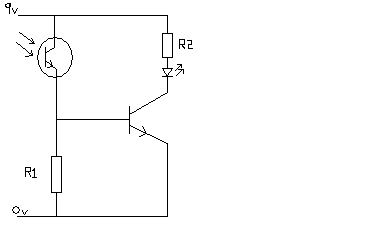

Thanks again guys.
From what i gather from your posts, you're saying that the previous circuit that i'd put up wouldn't give me enought current to power the LED. So by using the phototransistor in conjunction with a transistor i will get amplification of the current therefore powering the LED.
So my new circuit should just be the one that is attached.
Will the value of R1 have to change as well? I was using a 10k potentiometer to allow me to adjust it to the right value.

versimilitude said:
Thanks again guys.
To give you some level of control of the activating light intensity I would use the attached circuit.
The 330R is based on the LED having a 2V operating voltage drop.
Eric
