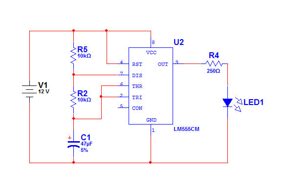

I have been working in Multisim to understand how I could use a 555 timer and a 4017 counter to solve my problem. I seem to be having a problem with the LEDs just flickering. I simplified and isolated the circuit to just the 555 part of the circuit and still the LED flickers in simulation. I tried different resistor and capacitor values but it doesn't change anything. Any ideas what I am doing wrong? (see attached)

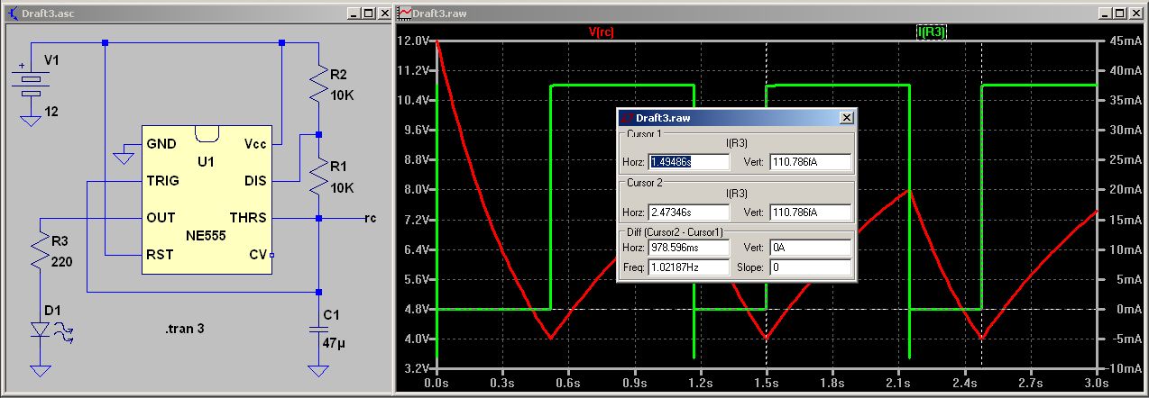

The 555 is wired as an astable, free-running multi, so yes the LED will flicker at the oscillation rate.
Look at these plots, they show what is going on. Is Multisim such a toy that it doesn't show this behavior?

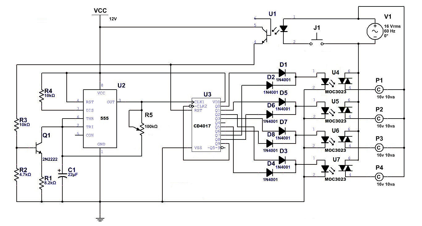

This is the design I came up with so far. I still have to add a regulator circuit to convert from the 16 VAC to 12 VDC to power the solid state part of the overall mechanism. I still need a little help with some of the AC/DC overlap areas.
1) What would be a good choice for U1 to take the AC momentary from the doorbell button (J1) to give the 12+ pulse to start the sequence?
2) Are the MOC3023s robust enough to power the plunger solenoids (P1-P4) or do I need to use some additional components to handle the current draw? What would that look like?
Any other suggestions would be greatly appreciated.

holabr - you clearly have better design skills than your initial question indicated. And whomever taught you how to draw a schematic gets a gold star.
Your schematic is almost there, If the idea is to cycle through the chimes once and stop, consider tying 4017 output "9" to the Q1 555 inhibit circuit. This will stop and hold the clock oscillator until the opto resets the 4017.
Now that the button-press reset signal goes to only one part, something else can be adjusted. If someone leans on the doorbell button, the system sits on note #1 until the button is released. Consider a differentiator between the opto and the 4017 to make the system more edge sensitive than level sensitive. In this way the chimes will start immediately with the button press, just like the original system.

I appreciate your comments. I like to build things but am pretty slow at design and at age 80 it is going down hill fast! In regards to this chime circuit by holabr: 1. What device would be suitable for U1? 2. Are the MOC3023's OK to drive the solenoids or do we need another TRIAC in between? 3. Since there is no "back door switch" what would be needed to accomplish just pulsing 1 solenoid?
Note that the schematic is not complete. Several current limiting resistors are missing. Also, the diodes can be replaced with 1N914, 1N4148, etc.
1. 4N35 or similar general purpose optocoupler. Add a diode in reverse parallel across the input diode and a series resistor to limit current to 10 mA.
2. Depends on the solenoid power. Non-repetitive peak current rating is 800 mA, but repetitive current is only 2 mA. Probably need another TRIAC.
3. The circuit does not show the relationship between either AC power let and the circuit GND, so this is not perfectly clear. The long way is to add another 555 configured as a monostable, triggered by the back door button, and connected to one of the output optos with another diode.
ak
A VO223A TRIAC optocoupler has a 1A RMS and 10A surge current rating which may be adequate to drive the solenoids directly.
You need to measure the solenoid current to be certain.
Note that the OR-function steering diodes at the output of U3 can be replaced by a CD4071 CMOS quad OR-gate, which would reduce the part count.
