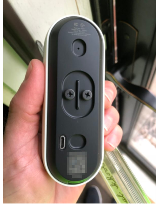

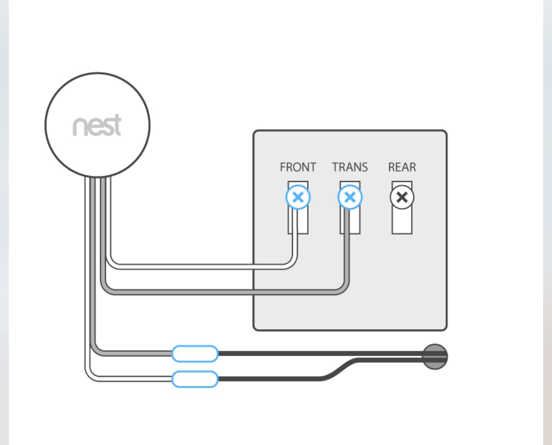

Sorry for being vague. This photo shows the wiring for the camera/doorbell. The wires to the button/camera are at the bottom. Your guess is as good as mine what the round thing with Nest written on it is. Others have said the camera works fine without it. The camera is powered up all the time by the transformer I assume. I do not have one in hand yet.
No the round thing is not the Nest thermostat, maybe just a junction of some kind, not sure. There are only two wires to the camera/button then the two wires to the transformer
Okay. Two wires, huh? It must be stealing power from the regular doorbell circuit from the doorbell transformer while somehow being able to drive the chime when necessary. But yeah, I think your general idea will work (there seem to be extra crap that needs to be hooked to the nest which I can't guess at).
In other words, wire it up exactly as per Nest instructions exactly like you would a regular doorbell, transformer and all, except instead of wiring to a chime, wire to the coil of a relay. Then hook primary contacts of the relay to your Control4.
Basically replacing the chime with a relay in a regular doorbell circuit which should mean that you don't have to worry about what the nest is doing as long as you follow nest's instructions.
Most any relay should work. Just pick one where the control voltage (coil voltage) is the same as your doorbell transformer output voltage.

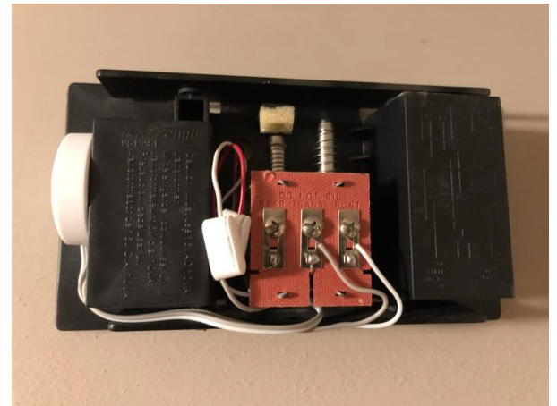

Hey what about this idea. I buy a door bell kit from Home Depot **broken link removed** I can take the plunger out of the coil that strikes the bell and install a mini glass tube reed switch inside the coil. Attach my Control4 wires to either side of the reed switch. Ring the door bell, magnet engages and closes the NO reed switch closing the circuit to the Control4 door bell tone circuit. Thoughts?
