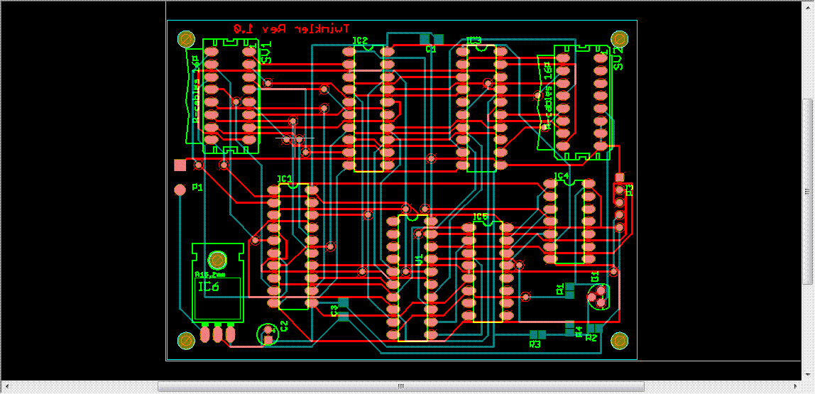

I drafted up a board in Eagle CadSoft and when I import it to Viewmate it does not import the drill file. I did my drill file in Excellon. Here's what I get:

I think that Excellon outputs drill coordinates in ascii for use by the fabricator's machinery. So there is no Gerber drill info to put into Viewmate, I think. I've generated drill gerbers by mistake before and they showed up no problem in viewmate, but when I corrected to excellon it doesn't import because its not supposed to.

Your excellon drill file should be a TXT file. If you are trying to import the .dri file, that's the wrong one.
In viewmate select a new layer and select file->import->drill & route. Select Options on the bottom of the open screen that comes up. You may have to fiddle with this. I changed the default for zero's to 'all digits present' and changed the units to 'metric' and the file imported correctly.
Cool! Let me try it. I already submitted it to a couple of board houses and they didn't see a problem but I always like to check my work first. Thanks DirtyLude.
The excellon file extension is .txt
Here's the import parameters I used for this, but I think I used different parameters before. Anyway, this worked.
