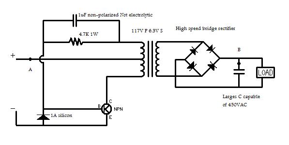

Does anyone see anything wrong with this circuit?
toreywood
I am new to electronics but have a basic understanding of the science.
Does anyone see anthing wrong with this circuit?
Maybe I should have said what is wrong with this circuit.
And What can I do to shut off the flow of the battery when the capacitor near point B is charged.
My goal is to get anywhere from 120VDC to 450VDC from a battery 6V to 12V. I only need a .5mA current occuring at 1sec bursts at random intervals anywhere from 2 sec. apart to 2hr. apart delivered to the load. These bursts are going to be triggered by an input from a outside sorce. (i.e. a starling landing on positive and negative points)
Thoughts are apprecitated.
Torey
I found the inverter part on the net and added a rectifier to make it DC. And a capacitor to create a burst when the points are closed.
How can I fix it?

Yes my intent is to kill these birds. I live on a dairy farm and currently I estimate the starling population to be 500. These birds carry diseases such as Johne's. I am looking to start a starling control business. The only way to control these birds right now is to have the US department of fisheries and wildlife to come out and poison the birds the problem with this is the birds are laying all over the farm when they are done. If they are shocked they will fall in one spot. And the USFW charge $500 each time they come out. A $100 device would go a long way.

You can add a bleeder resistor to ensure your high voltage capacitor drains when the power is removed. Not many switches will handle high voltage.

Is the bleeder resistor just a high ohm resistor?
Pretty much. Its value will depend on your voltage and capacitor size and how fast you want the capacitor discharged to a safe level when the power is off. It will waste some power though, and that will be an issue with a battery powered device. It might not be practical to have one, but would make the device vary dangerous to touch, even with the power off. You will certinly need a way to ensure the HV cap is discharged before you move or work on this.
What kind of battery were you thinking of using and how long would it need to last?
An AC voltage is generally more lethal than DC, so I think you want to leave the output of the inverter as AC, not rectify it. AC can cause lethal heart fibrillation, whereas DC acts more like a defibrillator.
To minimize power from the battery you could pivot the perch and add a microswitch with a small spring that would apply power only when there's the weight of a bird on the perch.
I would like to use a Sealed lead acid battery mainly because I can recharge it and I have one. 12V 5Ah. It would be handi to have the battery last more than 24 hr. That way I could have two per unit and each day swap them and charge the one not in use. But it is definitly not a problem if I could only get 6-8 hrs. out of it.
The only reason I switched it back to DC is so I could use a capacitor. Do you think it will deleiver an adequate shock without the cap?
If I used a microswitch would that control the juice from the battery? If I did this would the amount of time that the switch closed charge the capacitor the same amount that is being discharged? I would think that it wouldn't because that is the point of having a cap there to deleiver more charge than what can normally be deleivered through the battery. I agree AC would be better.
Correct me if I am wrong you guys are the experts.
Wikipedia states that 60mA of AC through the chest can kill a human but it takes 300-500mA of DC, so I would expect that either would kill a bird also. And a long duration shock is probably more lethal than the short shock from a capacitor, which may tend to just stun the bird.
Yes, you would use the microswitch to control the power from the battery. But, as you say, that would not work well if your charging a cap, only if you are applying an AC voltage directly from the inverter.
