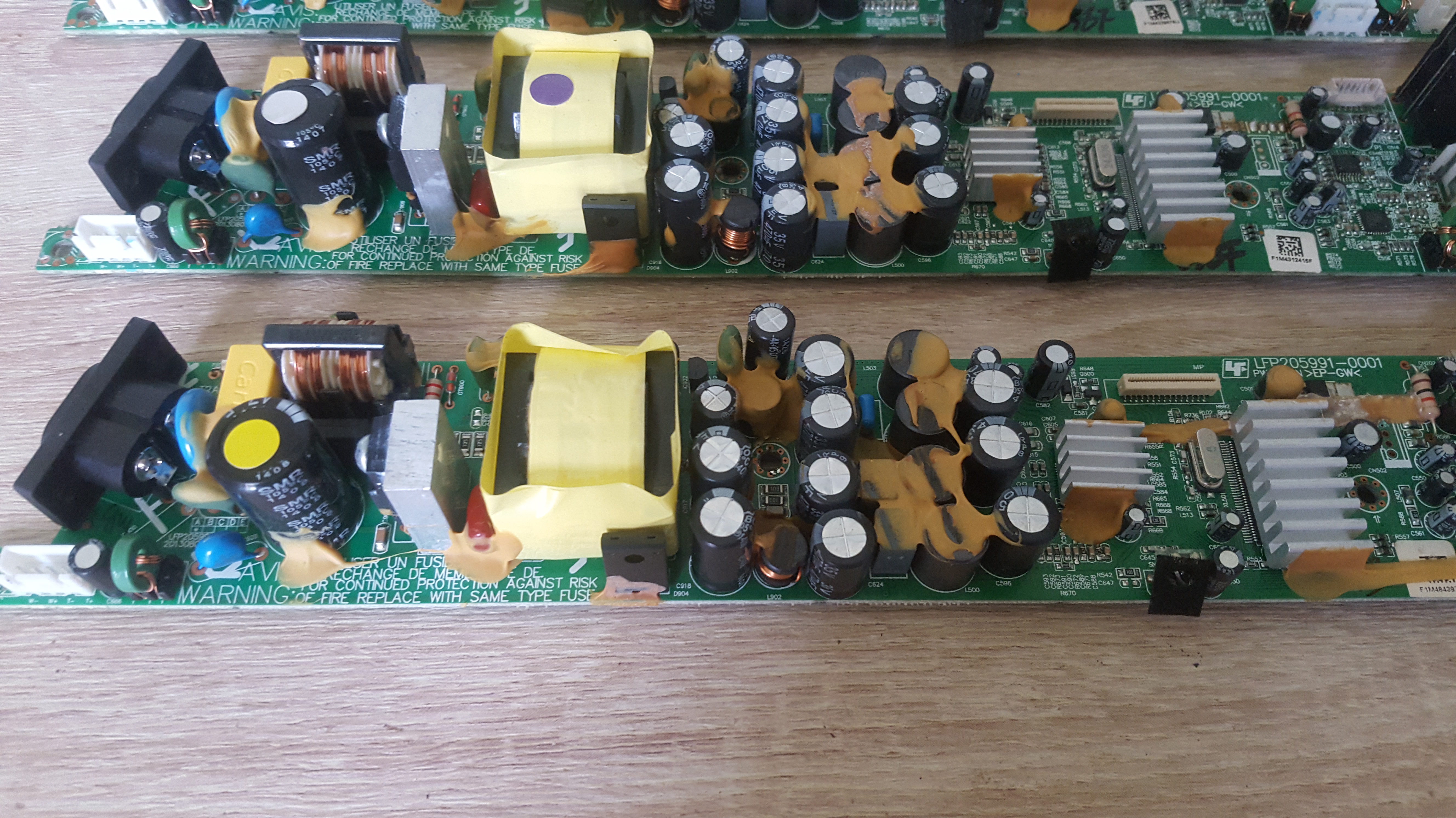

Does anyone know what this yellow substance is on my circuit board??
rego21
The yellow substance seems to be in the same places on both boards, I'm not sure if it's supposed to be there or not?? The circuit boards are from a power supply from a soundbar
It is sticky stuff, ie glue which was put there to help give some mechanical stability to larger, heavier components.
Many products go through a vibration test. Large components will fall off the board. The legs will brake after time. (glue)
LFP205991-0001 in Google reveals this,, may help,,check photo for arrow.

In fact, following your excellent link, if you check the original photos you can see that capacitor is domed, so most likely it's low ESR.

Thanks for the insight. Yeah I replaced the capacitor mentioned in the link and that sorted the problem for the two of them:D
