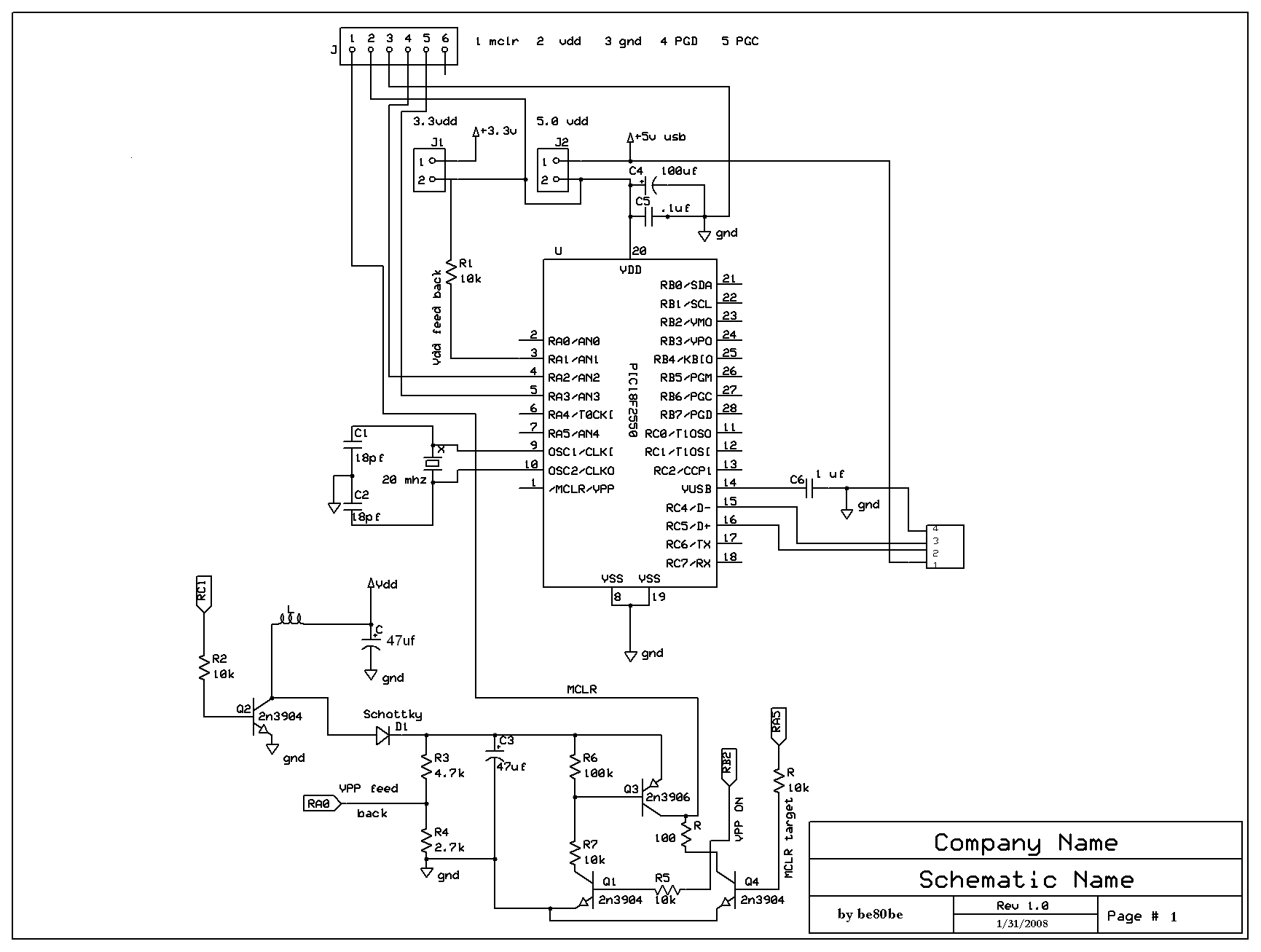

That's what I read to there a clone that is open source and has better software but I don't remember the name of it.
It uses a usb to rs232 bridge and the 16f628a to program your chips it looked nice. works with linux and piklab
yep the 16f628a has to be programed. So you take a spare chip load the new firmware on using the diy128 and then swap the chips. That s how I used to do it until I got a pickit 2 programmer. I got a few other programmers around too. its nice to have a spare just incase.

You could make a clone which work just as good or make a cheap clone with out all the bells like the program to go
I never used that option so i made a clone to have a spare good thing to have around

Ohhh, is it possible to make it on strip board ? that's make it much much easier.
You can use what ever I made with a pcb pref board even in a solder less beard board and it works
I have a pcb design for it to I just redid it for double sided copper and the size is down to 1 1/2 by 2 1/2 inch board
