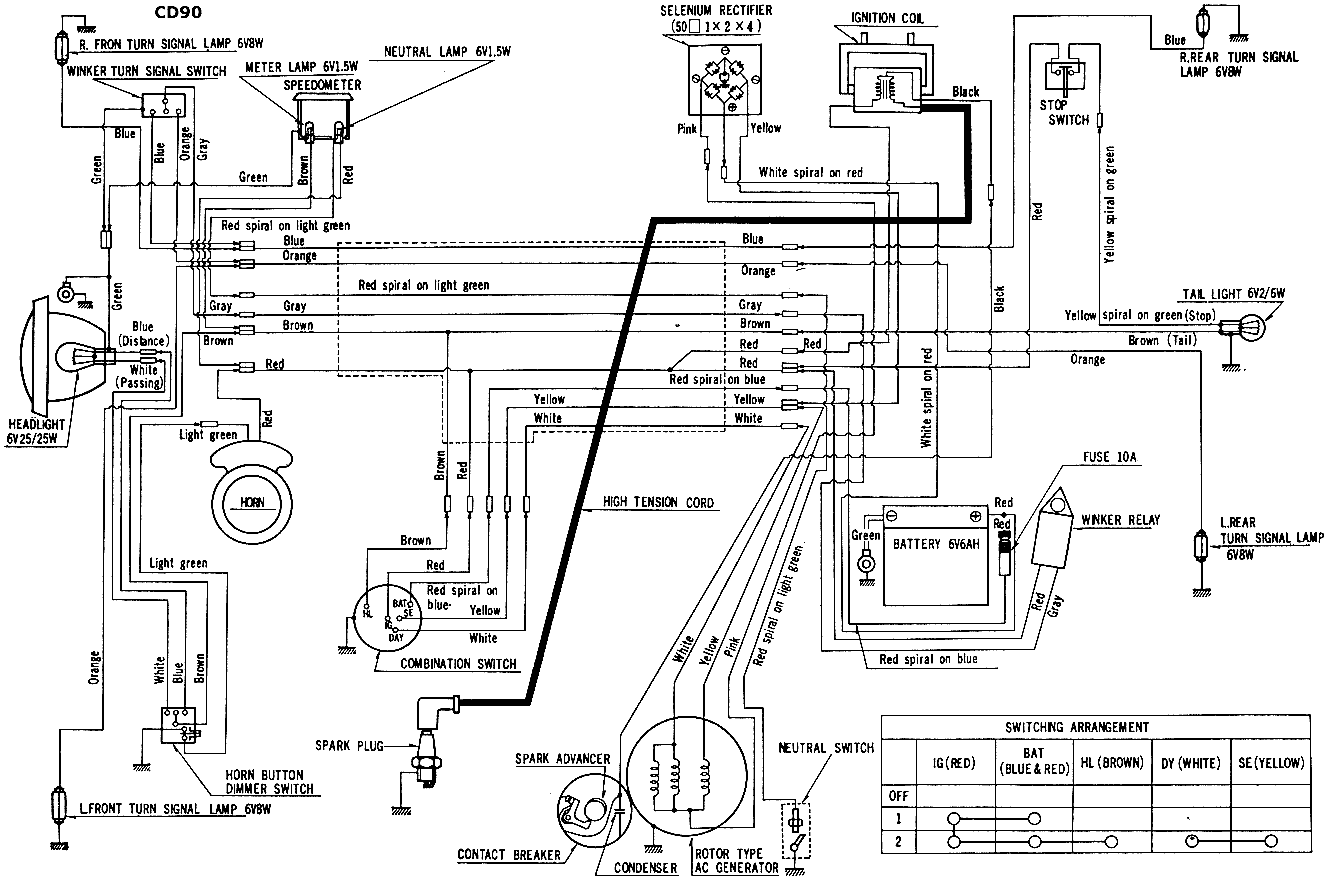

does any one know the motor bikes wiringsystem
mamun2a
dear,
motor/engine make current for its own use, bike has 5 wires come out from engine,
why five wires?
are all of them keep same volt and current?
does the wires use directly to electronic circuit?
does ny 1 know those solutions?
(bike: yamaha, 80 c.c, made 1985, battery 6V 4amp)
thanks
mamun2a, dhaka, bangladesh
i can tell you that some will be pickup coils (that is 2), the other 3 should be for the 3 phase stator.
do u have ne schametic of bikes wiring design, if have pls forward me.

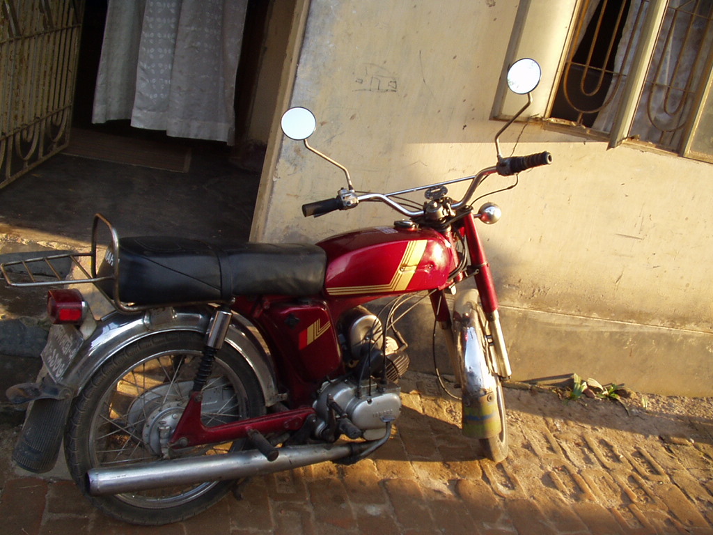

Well uuh, we don't even know what make or model of bike you have!!! So, what kind of a bike are we talking about? A scooter or a real bike? Have you tried searching the Internet for your specific bike's make & model.... like maybe start with the manufacturer!!
**broken link removed** **broken link removed**
Hi-Tech,
Love the pictures of the . . . . erm . . . . Bikes ;)
yamaha, 80 c.c, made 1985.
if doubt **broken link removed**see this is a bike or not.
pls help me with its wiring system....
here the bikes
some people doubt about the bike here it is :mad:
Don't take comments personnally, they were referring to the fact that it is a little bike.
Do you know the exact model of the bike. 1985 Yamaha 80cc is a little vague. A model number would help alot.
i have on diagram for some other bike. but i believe it will help you a lot.
Aily
mad prof may be, its all original docs r now lost so i cant ans ur guess. may be its fs -1., have u any diagram or fs-1?
Aily's dia helps me to undrstand wht dia it was, but if i get the original one it's cool.
I again wants to thanks aily.
thanks.
mamun
ok ne way, ailys cd90 s diagram help me to understand yamaha 80 s system.
