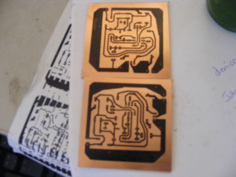

Well guys today I had fun trying to get my pcb design onto the circuitboards, as I run out of transparency paper I used the vege oil method on normal paper, this has worked before but today the UV resist didn't work. I had a bit of PnP left and every print out was stuffed due to errors :mad:
On the bench near my puter was a brochure we got from the primary industries dept. I cut it in 1/2 and the friggin thing got caught in the printer. But I did notice the transfer was purfect. I cut out some small sections as my pcb is only 75x75mm and it printed out purfect. My first iron on attempt didn't get 100 % coverage so I cleaned the board and with the next attempt I ironed on longer. It did work purfect so I did the second board and after spending close to 5 hours of stuffing around the yardarm arrived so I'll etch the boards in the morning.
For a first attempt using magazine paper I must say I am impressed so that forgotten project using a laser printer heating unit for a laminator is now back on the cards. I do have a heap of UV resist boards here but I will need a new laser printer as the one I have won't print images dark enough to use.
My next attempt will be a double sided board using the iron on method as this system is just so easy and did I say I was impressed?????
Cheers Bryan
